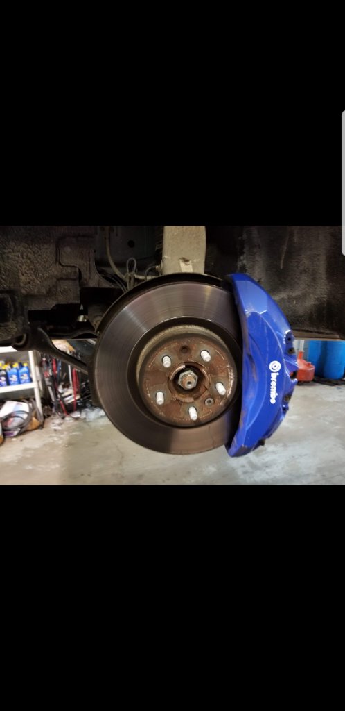

So I am aware that in 2018 they updated the brake calipers to the RRS Brembos. However What I have not been able to find out is if they also update the steering knuckle.
Can we simple bolt the same calipers (or better yet actual red or blue/SVR calipers) onto the 2017s...
Anyone offer any insight?

So I have started to play with this, and it seems I will only have to swap in a set of RRS rotors as well. They are 15" and have a slightly different offset, than the 14.2" stock D5/LR4 rotors. The back plate and lines will remain unchanged
Easy enough spring project :)

Do you have part numbers for the Brembo calipers, pads, and rotors?
