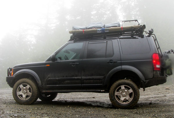

Interesting. Out of curiousity, does anyone know anything about the suspension on this rig?
This is my ideal height; I assume it's a body lift, now that you've all chimed in about the air suspension, but I still have to ask. If anyone can provide some insight, I'd appreciate it.
