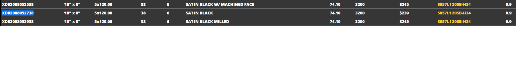

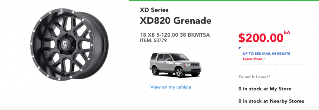

does anyone know if this wheel fits with no problems? I got this from discount tires. has anyone bought them? I once saw an LR4 with XD 18 in wheels but not sure if any modifications were made.

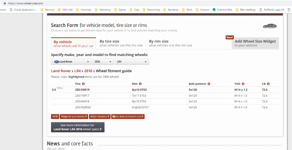

I just want to know the offset for Land Rover LR4 2016 +53 but on here it shows +38. is this going to matter?

Assuming the same width (8.0) for the 2 wheels you are comparing, ET38 would stick out 15mm more than ET53... which could be a problem.

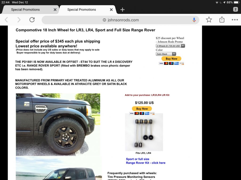

I’ve looked for compo but I can’t find them. What are make and model number of the wheels you ordered
3,041
1,807
The full name is Compomotive. A search will turn up all the info you need.
Fozzy325
Dec 9, 2013
68
13
I found them on johnsonrods.com
