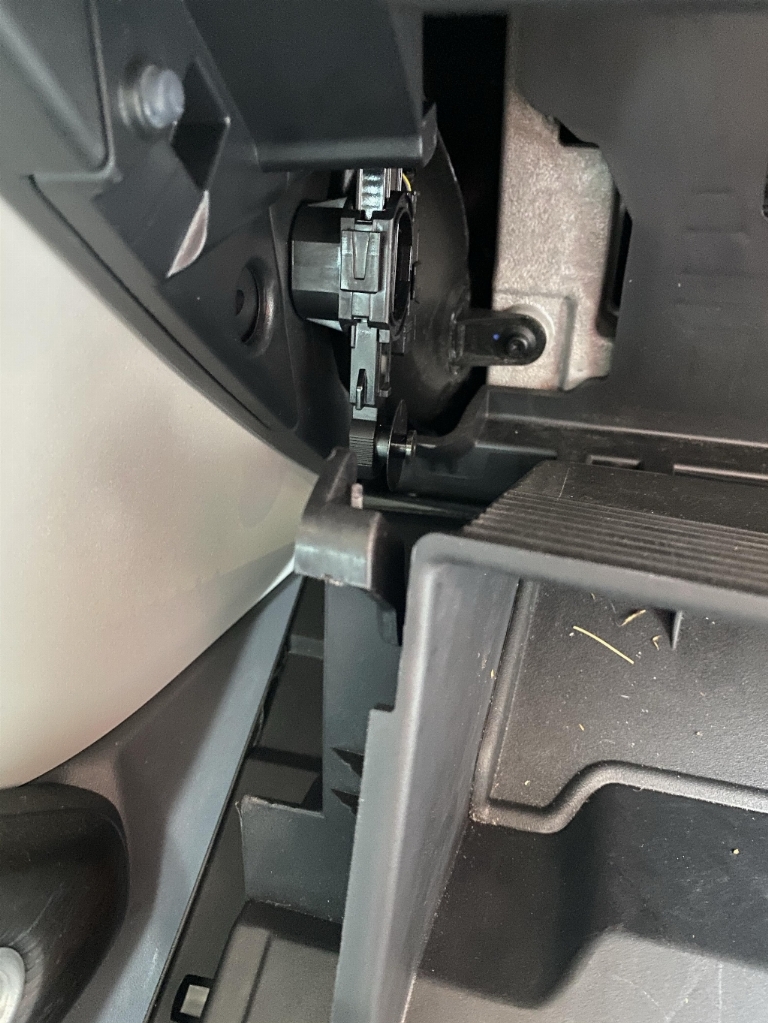

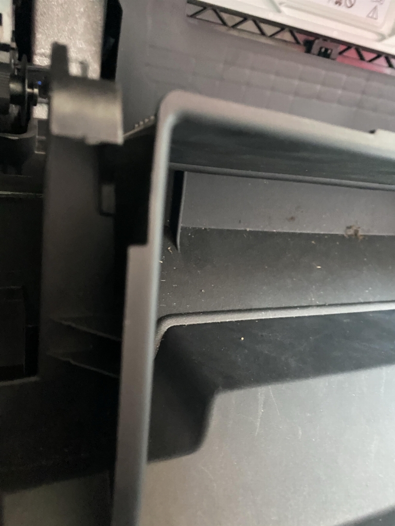

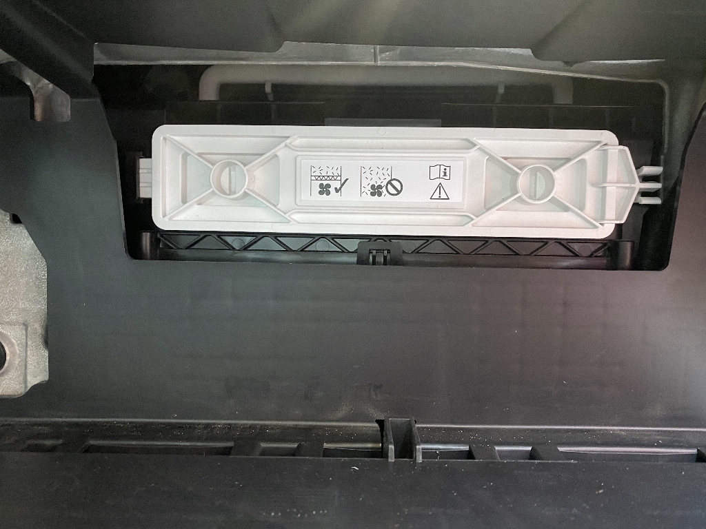

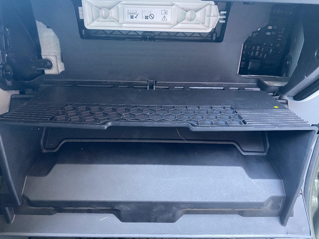

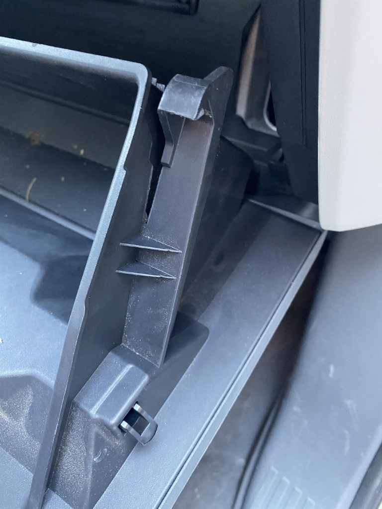

So, I did get this question resolved but it was quite an adventure. I took the truck to the dealership yesterday. I had purchased the cabin air filter from them the day before for about $60. After not finding anything in the manual or online about how to change the filter I stop by to ask the service center at my local Land Rover dealership. To my surprise, they did not know how to open it either. A couple of them assumed they did but could not get it open and didn’t wanna force it. This is the same problem my head. Eventually one of the gentleman didn’t get it open. There are just two tabs on the edges that need to be depressed, much like several of the other JLR products. It is apparently just a different set up and they were not familiar with it but we did get it sorted out. It’s stuck quite a bit and it did feel like we were breaking it when we first got it open but now it’s much easier. I will post a couple of pictures.
They told me that there’s nothing about it in the manual because they want the buyer to bring the machine back to the service center for replacement.
I attached a couple of pictures so you can see what the mechanism looks like. You can see the cassette for the air filter. It’s white. Hope this helps somebody, I do not like it when the manufacture tries to keep these things secret.
