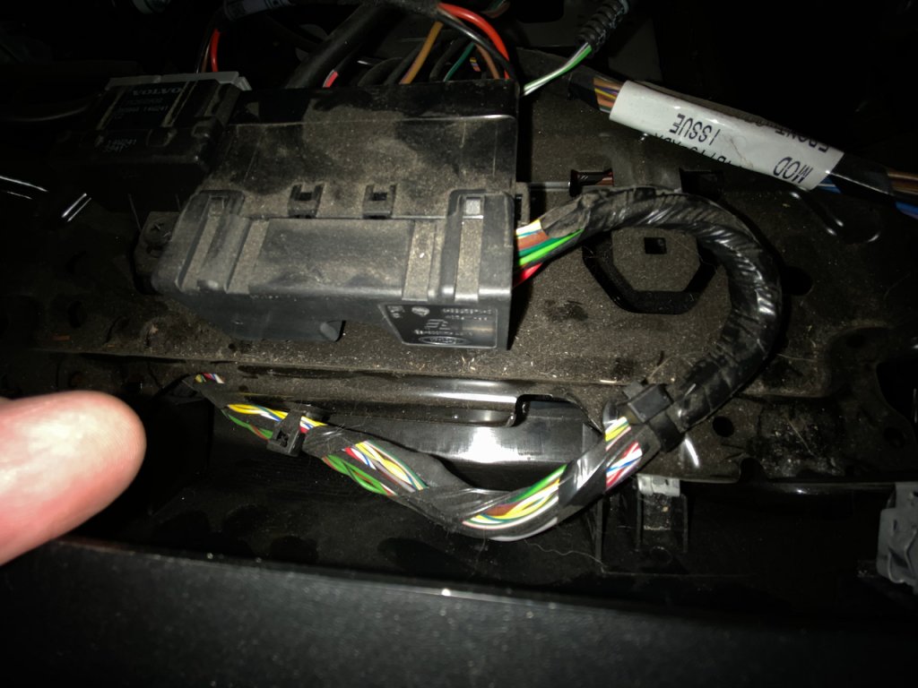

Hi All,
I tried to add the seat memory to my 2014 LR4 HSE, which has the memory module under the driver's seat and it's not working. With my GAP tool I changed the Memory functionality to "With memory" and Memory seat movement to "Fitted." Does anyone have any other ideas why this might not be working?
To test I did not fully re-assemble the door trim panel. I did connect the two main wire harnesses to the door panel and of course the connector to the seat memory/door lock switch, but since I did not clip the panel back onto the door I was not able to fully close the driver's door. Does it need to be closed for the seat memory switch to work?
Any ideas would be appreciated.
Thanks

Can you post pictures of the module and wires?
It's difficult to get a good picture of the module. Also attached is the wiring diagram provided by GAP. I contacted them about this issue. He said I do not have the DSM (Driver's seat module) ECU installed from GAP: "You need to purchase the correct part, ECU and install it physically. Else, you may have a wiring, fuse or other issue to address.
Good luck
