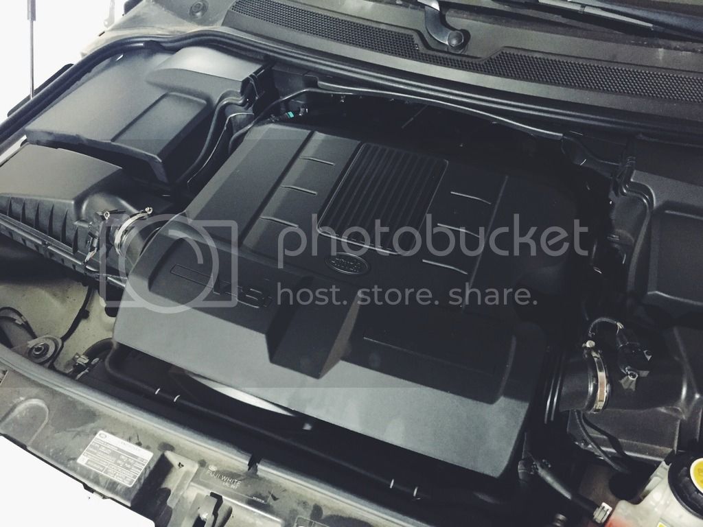

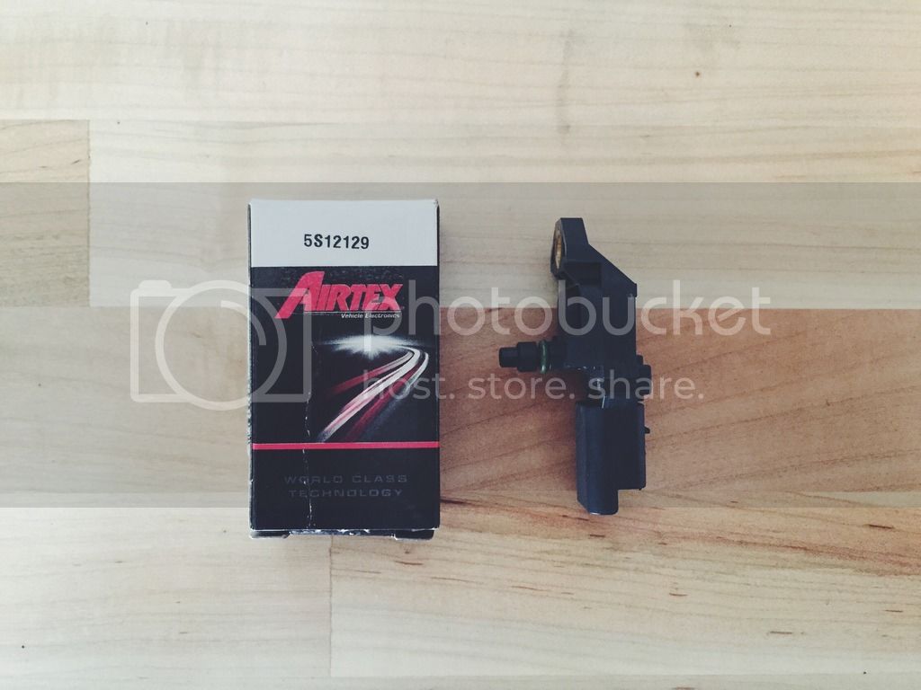

Had the chance today to change the barometric pressure sensor on my LR4. She had thrown a MAP sensor code with CEL twice so I figured I would just go ahead and change it.
DIY is as follows.
Tools needed -

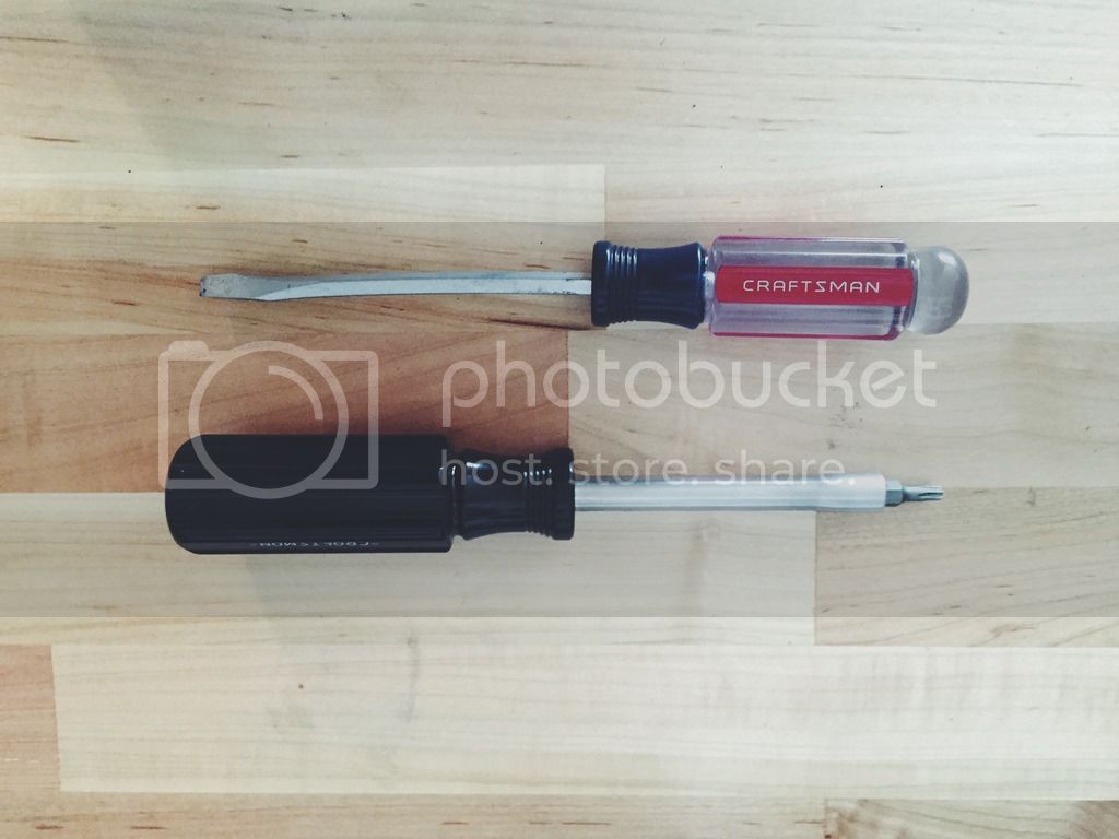

- Flat Head Screwdriver
- 20mm Torx Bit Screwdriver
- Gloves (if your a clean freak)
- Your favorite cold one
Parts needed -
AIRTEX MAP Sensor Part # 5S12129
DIY is as follows.
