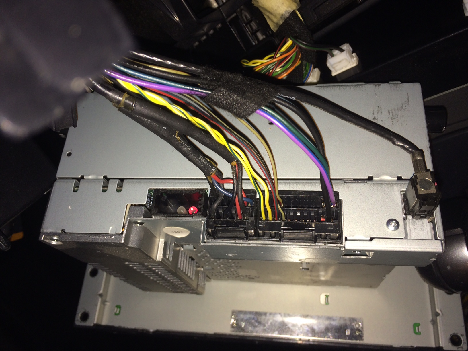

Took out the head unit and nav unit to check for loose connections. Disconnected all the wiring and reconnected - no change. There is only one light coming from the back of the fiber optics on the head unit. I've attached a pic, I'm not sure if both are supposed to be lit up or not?

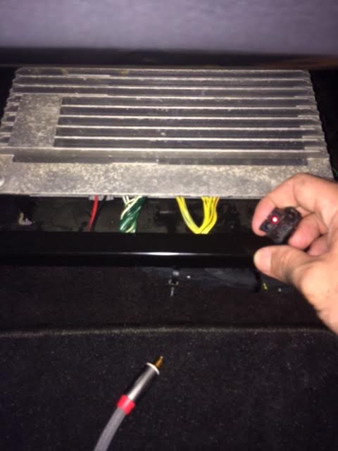

Inspected the amp under the passenger seat. No loose connections. Disconnected the wiring and reconnected- no change. There is only one light coming from the amp wiring. Again, not sure if both are supposed to be lit or not?

I don't know what else to do. Pics are attached of the fiber optics lights. The head unit pic is upside down, so the side that lit up is the passenger side.

Maybe it is the amp?
You seem to have checked everything that I would have looked at, hence I am puzzled.
I assume you have looked thru the various files I have in my gallery re the link below for wiring diagrams and the like.
There is a shop in California that does repair the HK amps but before you send it off, you have to know it is the problem. The amp does suffer from internal broken solder joints so the fix is not too difficult once you know what to look for.
About the only other thing you could do is get one of those fibre optic loops that jumps a MOST connector to bypass say the Bluetooth or Display, but it sounds like the Voice Recognition Module and Display units powered and OK.
