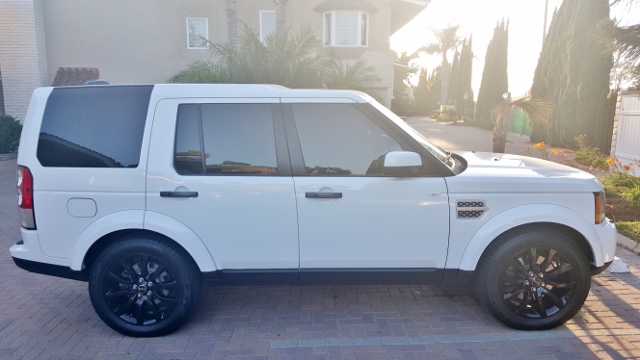

Thanks for the help. I am getting them coated black and will install them on Monday. I will post a picture for those who might be interested in buying RR wheels/tires for their LR4. I like the fact that the offset is 6mm more aggressive than my stock 20" factory LR4 wheels. Of course I think the 255/55/20 tire will look much better than the current low pro 255/50/20. Here is a pic of the wheels right before going to the powdercoater and leaning against the truck.

Yeah, when I had the RRSC 20" on my LR3, they looked awesome with the wider stance.
A word of advice to make extra sure they know about, absolutely make sure they will mask off the center bore chamfer and then mounting face. If not, you will be very unhappy with the poor fitting issues afterwards.

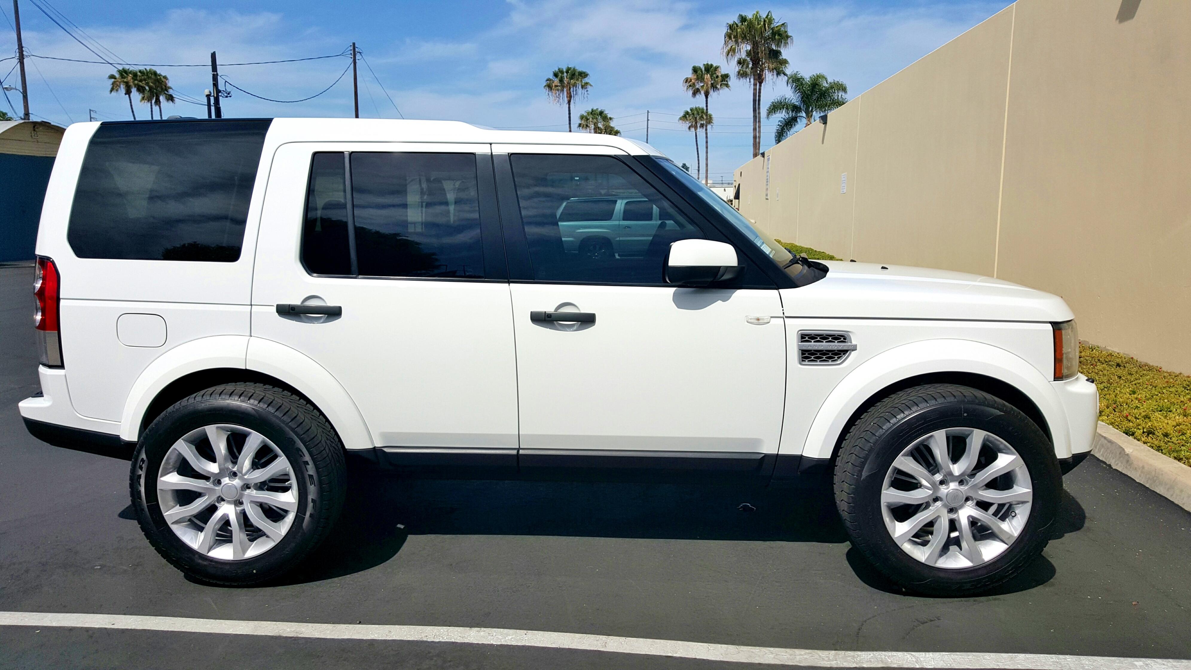

Here is a pics with the 20" RRS OEM wheels/tires. I think the 255/55/20 tire is a pretty good fit for the LR4. No rubbing and the tire itself is exactly 1" taller than the stock 255/50/20 tires. The rim itself is 8.5" wide, same as my original wheels, but the offset is 6mm more aggressive so the rim /tire sit out 1/4 inch further than stock. 20" RRS wheels/tires are inexpensive on EBAY (as guys with the RR generally don't like the smallisth 20" wheels) and a nice alternative for the LR4.

Nice job! Good to have more wheel / tire combination info. It's by far the most asked about topic on the forum from new users.

Hey! I am just working through exactly this build for my 2006 LR3, so it's right on the money! In fact, I am even using the same rim -- though I am going up to a 275/55/20 (and a touch of lift).
I am a little worried about the load rating for the rim, though... The Disco3 forum insist that RRS rims are lower rated than the LR3 rims (915kg opposed to 940). When I picked out my rims, I looked for photos of the rear online, and the rim indicated 950Kg (10kg more than the stock LR3). Can you confirm this because I load up my Rover pretty heavily.
Also, can you confirm whether or not there was any issues mounting the rim? I am assuming that the LR3 has the same centre bore as the LR4 -- so will my rims (the same as yours) fit without a centric spacer? Have you had any vibration issues since?
One final question, my LR3 always sits up at the back a bit and yours (and most I've seen) sit level -- I have a 1/2" electronic lift atm, but is the height meant to be up a bit on the LR3 and level on the LR4?
