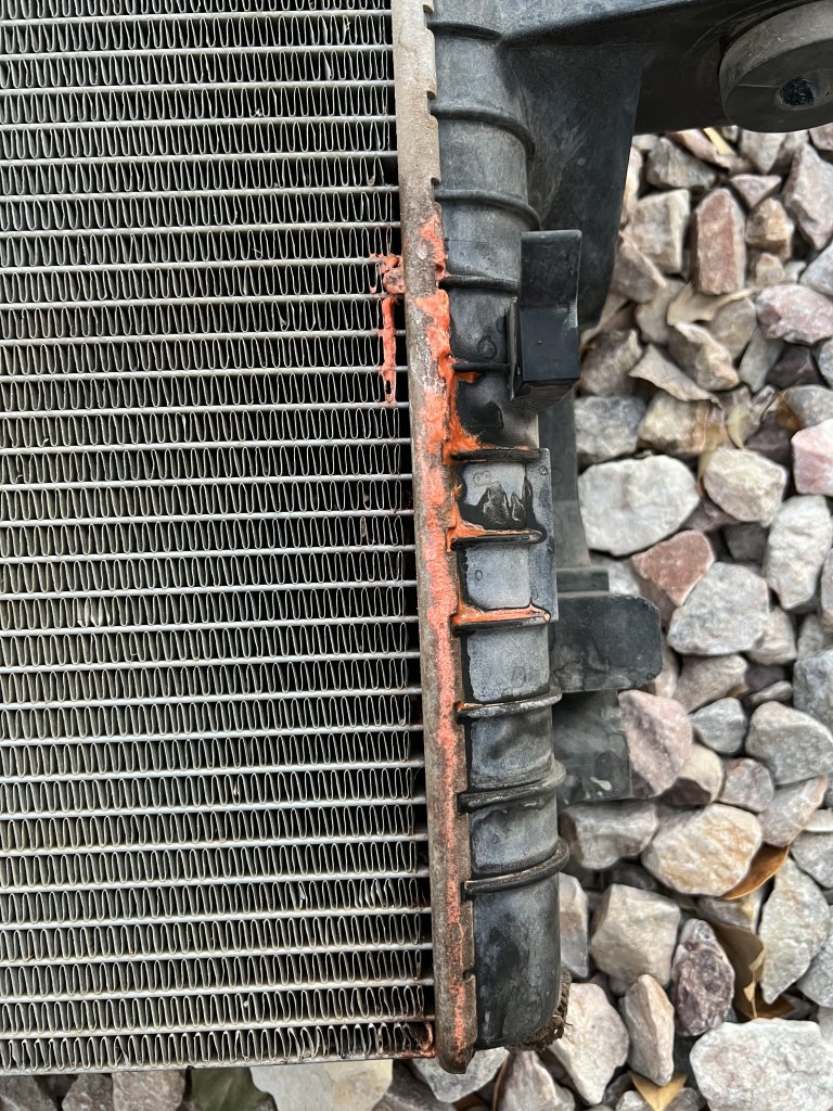

So my radiator has a small leak in it, and I'm looking to get it replaced.
I see 3 options for replacement radiators, Nissens, Eurospare, and the OEM from Land Rover. OEM would be a no brainer but has anyone had any experience with the Nissens or Eurospare?
Also, a shop I called said the AC needs to be evacuated/recharged because the ac condenser lines are in the way to remove the radiator, anyone know if there's a way around this? I thought we were able to remove the fan shroud/fan, headlights/grill and fish the old radiator out somewhat easily?

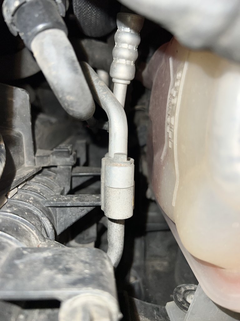

So I’m pretty sure that evacuating/recharging the AC system is required. Looking at this condenser line, it’s attached to the radiator
Who designs this and thinks this is okay??
I got a quote of around $800 in just labor to replace the radiator… was honestly looking forward to doing this myself too… I don’t think it’s worth buying/renting AC system tools for this project.

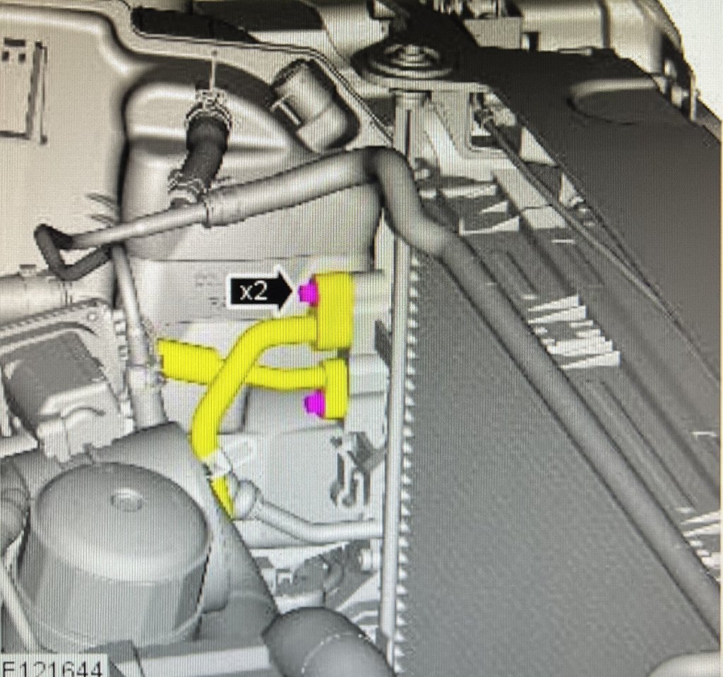

View attachment 21572View attachment 21573
I’ve replaced and LR3 radiator and LR4 radiator without disconnecting those lines. The key is DON’T FORCE anything. It will take some maneuvering but with the condenser, radiator, and receiver drier all disconnected, you’ll have to “angle” the radiator a bit to maneuver it out.
Same thing when going back in.
And MAKE sure you compare the new radiator to the old, as some of the mounting points are slightly different.
Get the Nissens hands down, that’s what I’ve used both times and it’s a great unit.
PM me if you need any help.
