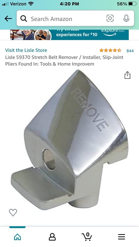

blake aiken
Mar 13, 2019
47
39
denver co
I picked up one of these from autozone or something
