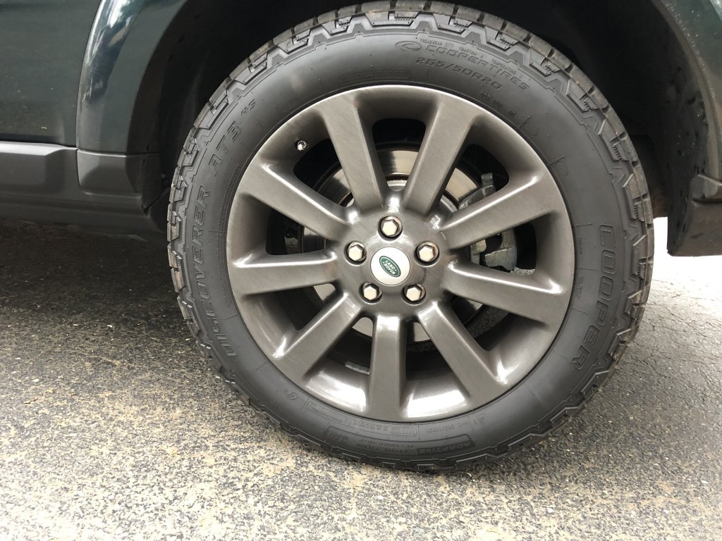

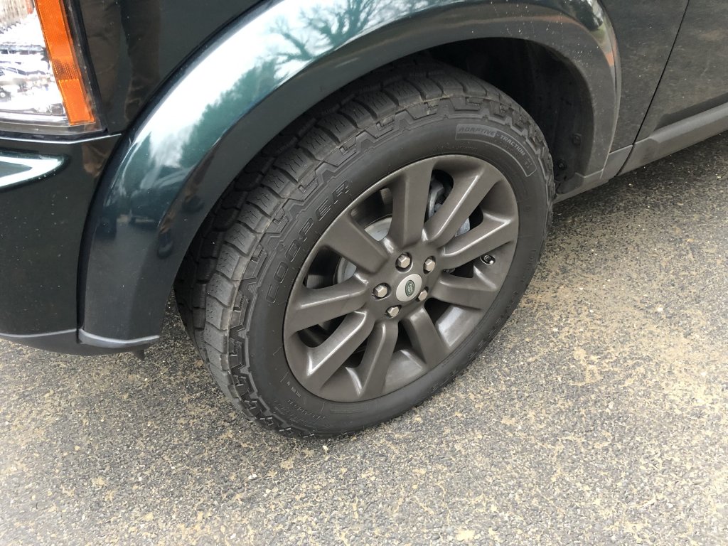

I figured I would throw some pics and info on the wheels we installed on our LR4.
Wheel specification:
  • RRC502690
  • ET53
  • 20x8.5"
GSD Powder Coatings refinished them in Kingsport Grey

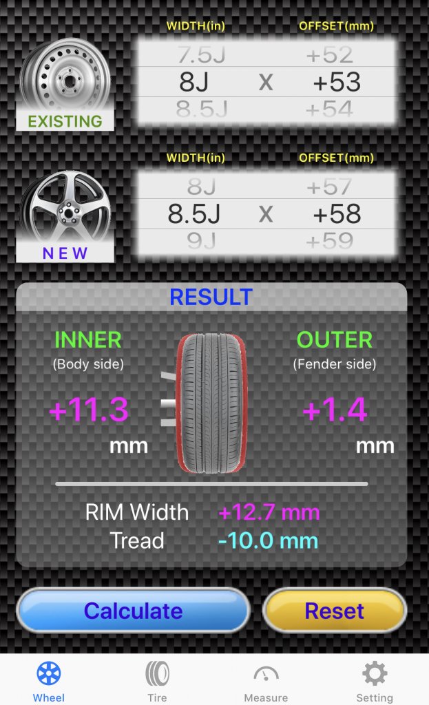

According to my Wheel Calculator app this wheel is 1.4mm wider on the outside and 11.3mm wider on the inside compared to the stock 19x8/ET58 wheel.

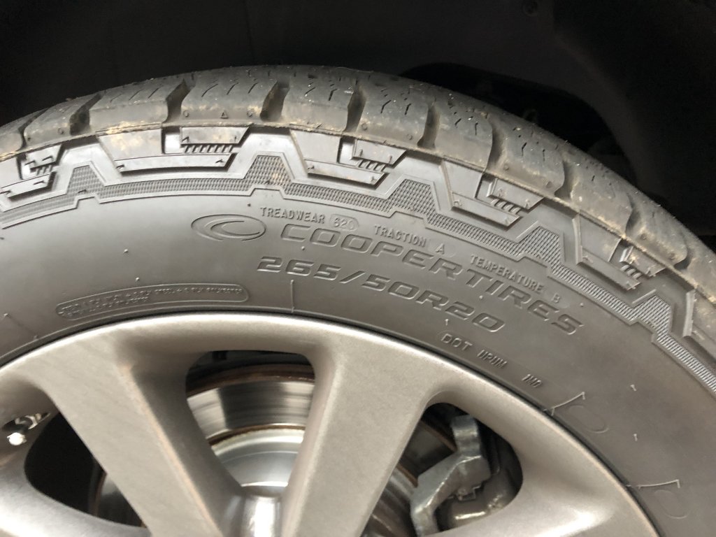

Tires specification:
  • 265/50-20
  • Cooper Discoverer AT3 4s
  • XL/111 Load Rated
  • 30.5" tall
We don't have many miles on them yet but so far drivability, noise and handling have been great. They have a 3 peak mountain snow rating but we haven't driven them in snow yet.

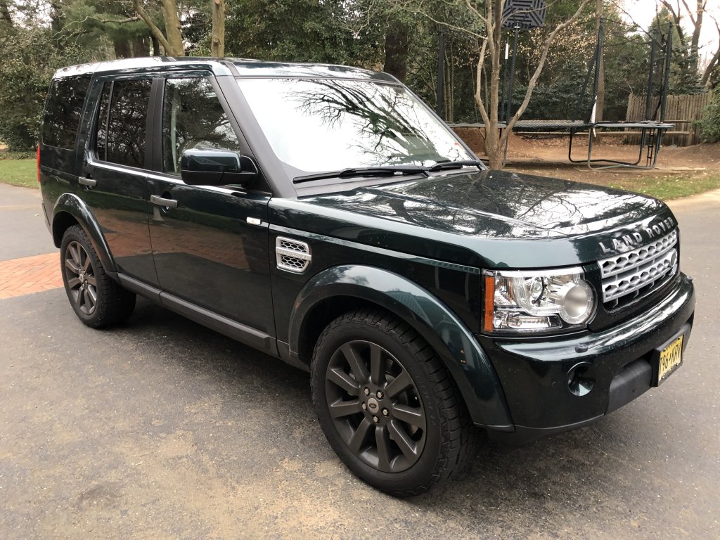

Looks awesome! I’m currrntly trying to decide which 265/50r20 tire I want to go with. I haven’t considered the Coopers, but they’re now on my list!
Can you post a full side shot as well?

And I'll try and get a side shot pic up in the next day or 2

Are you running spacers with these? If so what size? Looks great!
I was under the impression the offset on these was 58mm

I am running NO spacers with these wheels.
And I just checked my spreadsheet and you are correct they are 58mm offset. Thanks for correcting that!

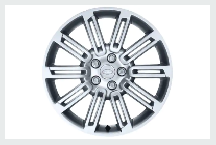

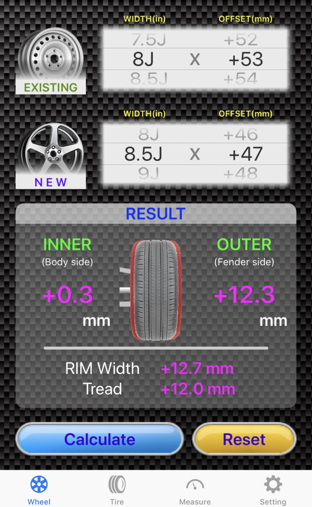

Those look good. So the OEM 20" 10 split spokes (8.5" and 47mm offset) should fit 265/50-20 no problem? They should "stick" out 11mm further than the ones above?
2,629
1,292
Ok great thanks so it pushes all the additional width to the outside. I guess rubbing the liner on full lock is a possibility along with a little more spray down the sides.

To the OP. I just noticed than the 265/50-20s have a load index of only 107. The 255/50-20 at 109 is already downgraded from the stock 255/55-19 at 111. Any concerns there?
107 = 2149 lbs
109 = 2271
111 = 2403
GVWR 7143 / 4 = 1786 lbs.
Still within limits I guess?
