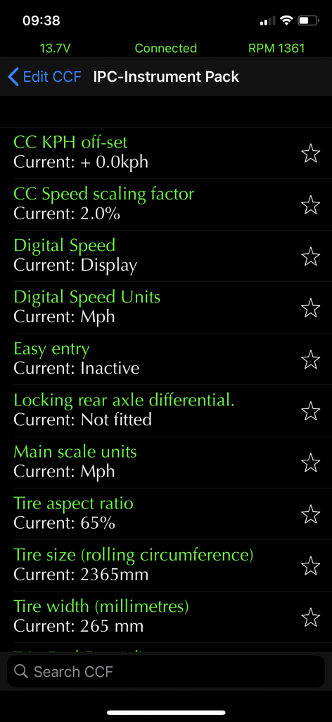

Hey guys,I’ve been trying to re-calibrate my speedometer with my IID tool and I’m having a bit of trouble. I am running 265/65/18s with a total diameter of 31.5 inches. I told the IID tool that I had 32 inch tires and I was on the freeway and the speedometer says I’m going “72” MPH but Waze says I’m going 79. I could also tell that I was going much faster then 72 MPH so I’m just a bit confused on what I am doing wrong. I am doing this under Tire Size MSB - IPC. Anyone else had this issue? And for the guys who run the same tire sizes me, what did you put to make it accurate?
Thanks!

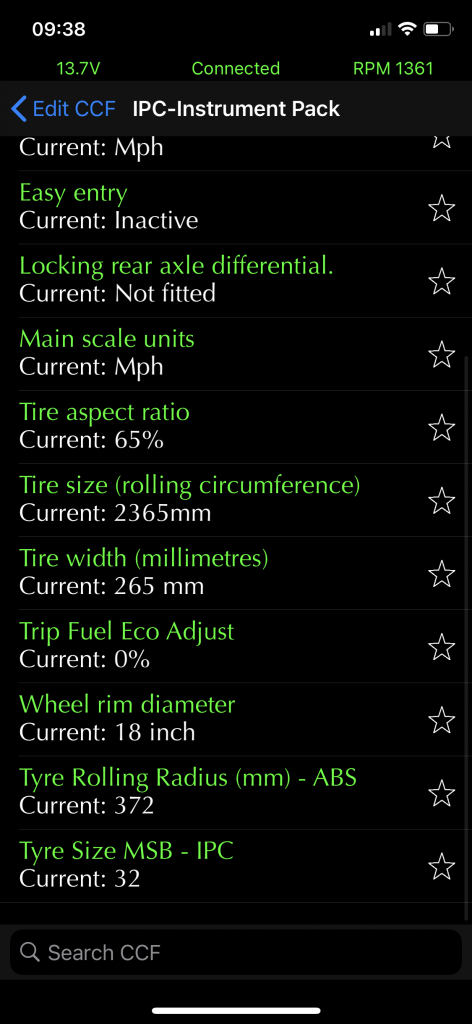

Here are my settings as of now

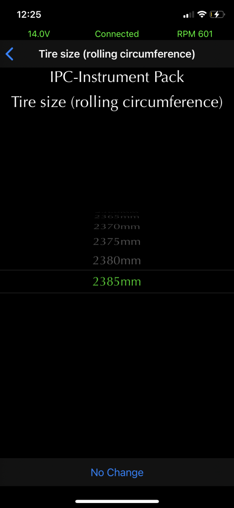

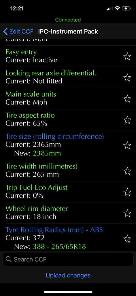

change...
tire rolling circumfrence to 2517
tyre rolling diameter to 402
