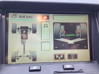

Hi, this is my first post to the forum and I'm hoping this might be helpful to others. I couldn't find any other forum with my specific suspension symptoms. For about a year, on and off, my 2006 LR3 SE V8 would get the message: System Fault Special Programs Unavailable; Special Programs Off. The red suspension fault light would appear on the gauge cluster, and I would not be able to raise or lower the suspension from normal height nor work the special programs. The fault would pretty much remain for several days or weeks or it would come on randomly while driving only to disappear a second later. I also noticed that the problem tended to appear in the summer. The suspension would not lower to the bump stops nor would the suspension seem to slowly lower over time as the compressor wasn't working with the suspension fault light on. So I knew there was not an air leak. A year ago I bought the EAS compressor rebuild kit which provides a few new washers, etc. and I also replaced the dryer, but the fault remained. So, I figured it must be an electrical problem. The 4X4 info screen on the navigation also looked very different from other forum posts I had seen (most show one wheel out of whack). I have attached the pic to this post.
