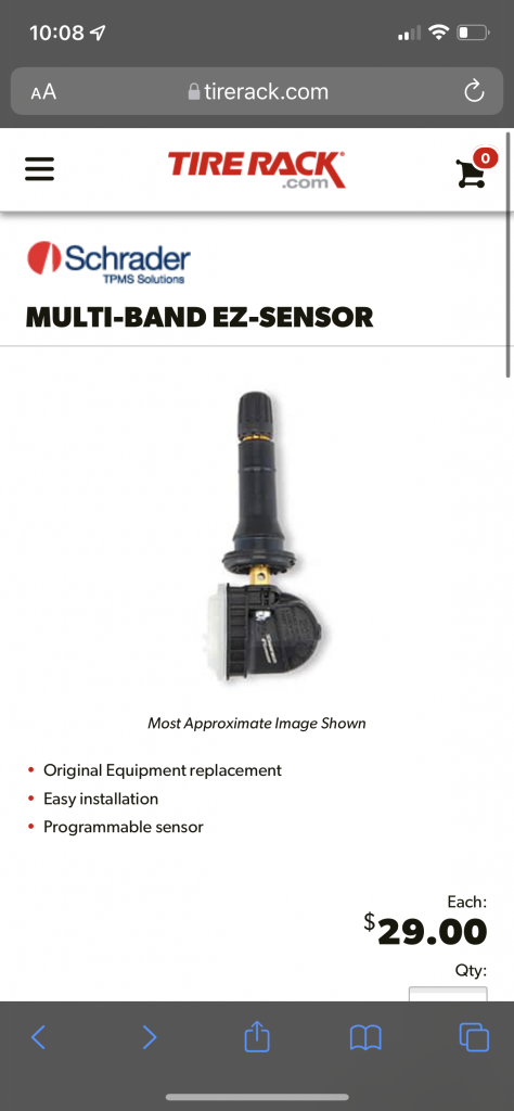

Can anyone confirm these tire rack Schraders fit with the tuffant 44’s?
I saw a thread with these earlier but was looking for other confirmation.
Schraders

I'd be curious if they work, much less fit. In my experience, the only TPMS I've found that actually work are the OE Land Rover ones.

Here's another datapoint -- I put HUF UVS sensors in tuffants on my 2016 -- pretty weird, most mornings 2 sensors will be detected by the car, throwing the light after about 20-30 minutes.

I recently had an original, 7 year old, TPMS sensor go down. I took the opportunity to replace all four (left the spare wheel/tire alone) with Continential units from Rock Auto.Continental TPMS Sensors
What year is your LR4?
Discount Tire had a hell of a time finding a TPMS that would work back when I had my OE 19" wheels and picked up an extra for a full sized spare. They eventually had to just get one from the Land Rover dealership. It would be nice finding another one that works.

I believe OEM is the Continental ones. Lucky8 has them on their site, I was going to refresh mine when I got new tires, but the supply chain issues thwarted those plans. I'm still running the original, which still work for now (knock on wood!)
