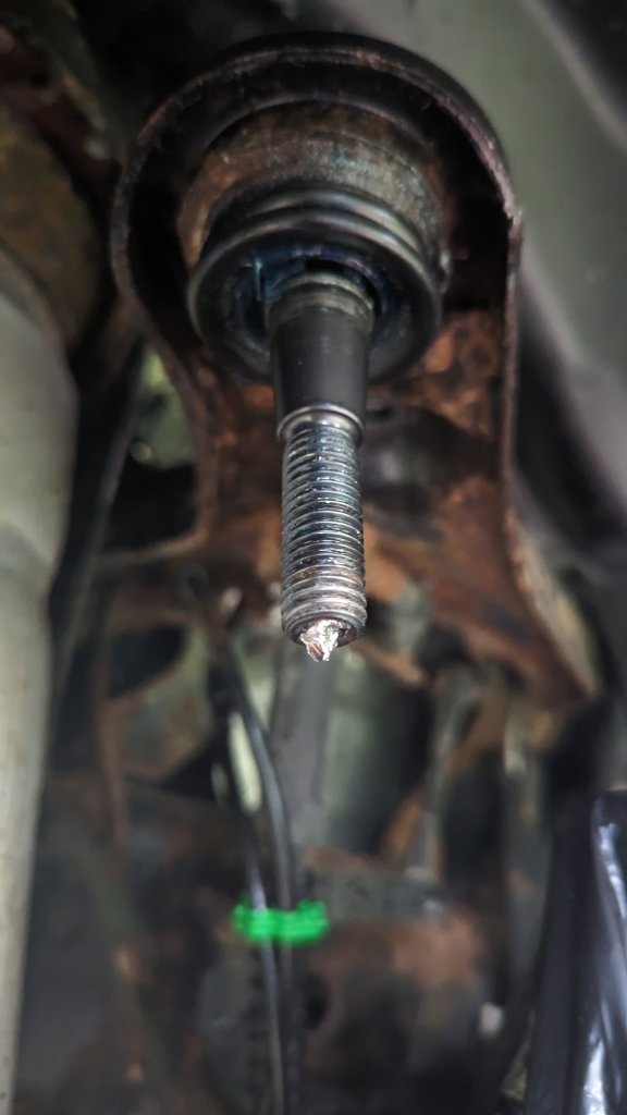

Upper ball joint hex broke- any advice getting this back together?
JimmyY
Oct 24, 2021
19
Canada
Having a hard time with this UCA ball joint. Hex was rusted out and nylon bolt would not break away from the threads. Managed to bang a T35 up into the bolt to break the nut free- but in the process I snapped the T35 inside!!!
Can't drill or knock it out now. Think I can buy an equivalent bolt (M22 1.5)without nylon in order to torque it up without spinning the bolt? I already tried ratchet strapping it into place, but bolt kept spinning. This nylon bolt barely budges - obviously for safety, but damn.
I do need to get my grease gun to re-grease the boot.
Thanks !!
Rover Range
Jun 13, 2022
553
303
Texas
The hex stud should be held stationary while you turn the nut to loosen.
Never the other way around.
JimmyY
Oct 24, 2021
19
Canada
Yes, in that process is snapped off. I figure if I get a nut without nylon I won't get any movement on the bolt and I can torque it up. I'm going to try grinding it out today with the Dremel, fingers crossed I can punch a new hex head into it.
Rover Range
Jun 13, 2022
553
303
Texas
An air/electric impact wrench will spin the nut fast enough to screw it all the way on.
ftillier
Supporting Member
Supporting Member
Jul 27, 2021
599
294
Portland, OR, USA
I must be missing something, but why is the next step not removing the ball joint and replacing it with a new one?
JimmyY
Oct 24, 2021
19
Canada
Upper ball joint is fine, I just had to remove it to replace CV axle. The nylon nut gets caught up too much to impact on. Are these meant to be a one time use ? Maybe I'll order a new nut. I torched the crap out of it today but no luck. I really banged up a T35 into stud to get it to hold, so it's jammed up there pretty good.
Rover Range
Jun 13, 2022
553
303
Texas
The nut can be reused. A new nut wouldn't be any easier to install.
Try taking a ratchet strap and compressing the ball joint stud into the spindle.
It may hold the stud enough to tighten the bolt.
