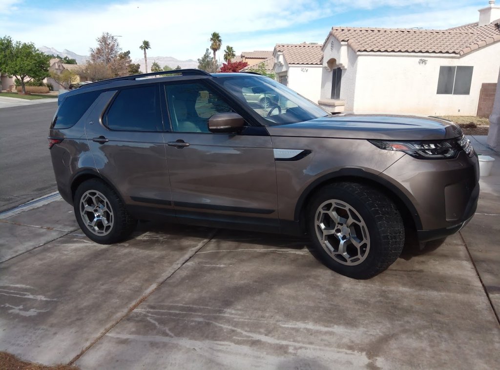

I swapped the stock 255/55-20 Goodyear Eagles on the OEM 20" x 8.5" wheels for 285/50-20 Nitto Terra Grappler G2s on Redbourne 20" x 9.5" wheels. Redbournewheels.com (which only does after-market Land Rover/Range Rover wheels) has a wheel configurator that allows you to see how your vehicle (including the color) will look with their various wheels.
