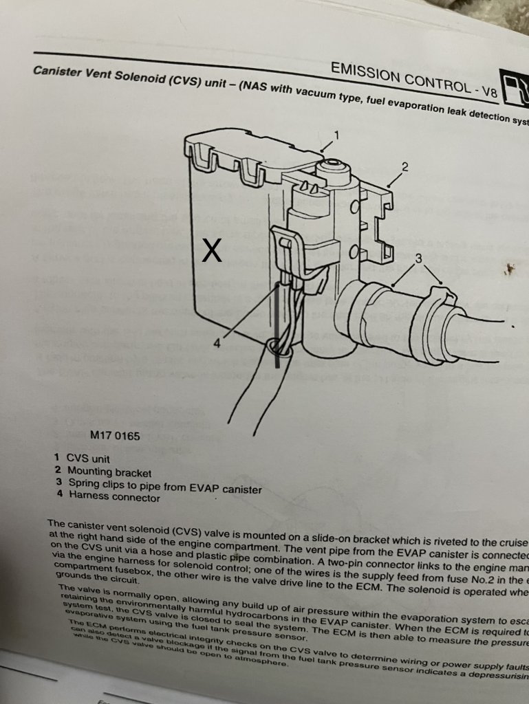

Ok here’s one for you guys-
So I hit the P0447 code, blew out the lines etc., but what I’m thinking is I may need to just replace the CVS unit. WELL HELL, I’m running into a brick wall. If you look in the manual under emissions control you’ll see the canister vent solenoid (cvs). It’s the #1 in the pic. I placed an X on it. I need JUST the unit & I’ll be damned if I can find it without the Valve etc ($800.+). It’s just the unit I’m looking for. ANYONE have ideas? Yes, I’ve spent hours searching online & calling or emailing all the top suppliers of parts. However, please make any suggestions, as maybe I’ll get lucky & have missed one. I really appreciate ANY help I can get with this. Thanks, Sonny
