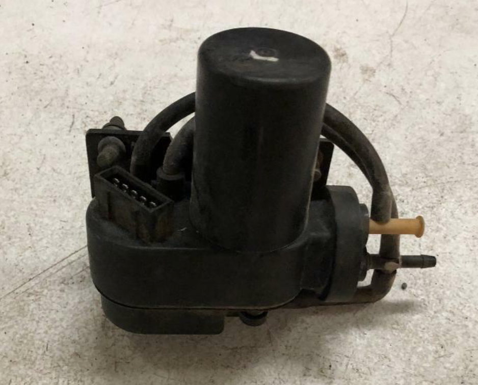

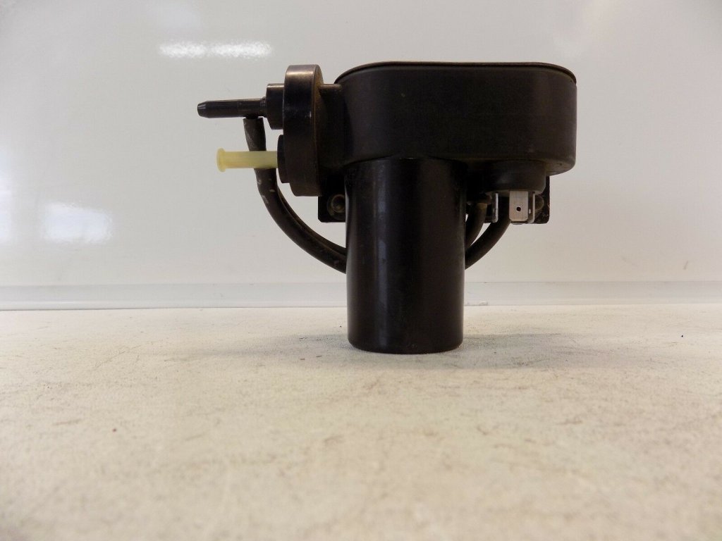

Question: I received an actuator with a different connector. The seller listed a false photo. Anyway, is it possible to get a connector that will work with it?
(mine is the square connector, the new one has 3 prongs)

Replaced the motor and everything works now. Make sure you get the correct connector. The seller sent me the correct one.
