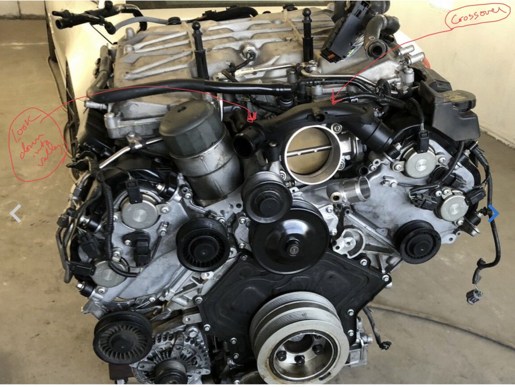

Not sure if the truck has a front coolant crossover pipe under the S/C and intake? I cannot find a definite answer on this. I have a 2010 workshop manual and no mention here either of a coolant crossover pipe under there? I'd hate to take it all apart just to find out it does not exist. Maybe someone here will know.

Pretty sure you have a front (and rear) coolant crossover. I assume your engine is like that in the attached pic. I indicated the front crossover, which actual dives down under the supercharger where it enters the block. They usually fail along a seam or right at the entrance to the block. Mine started with coolant smell - no leak, passed the pressure test three times. I finally just took it apart and sure enough, it was toast. Look down into the valley as indicated in the pic.

Pretty sure you have a front (and rear) coolant crossover. I assume your engine is like that in the attached pic. I indicated the front crossover, which actual dives down under the supercharger where it enters the block. They usually fail along a seam or right at the entrance to the block. Mine started with coolant smell - no leak, passed the pressure test three times. I finally just took it apart and sure enough, it was toast. Look down into the valley as indicated in the pic. View attachment 12510
I recently had to have that plastic part replaced on my wife’s 2013 RRS Luxury with the NA 5.0. No puddles or drips with that either but it puddles under the intake. The seam split on it. I haven’t had that problem yet with my 2012 RRS SC.

I see it as a ticking time bomb. So many people have had them leak that it’s got to be just a matter of time. Interestingly, some of the older V8’s had aluminum pipes. Hard to find, but I’ve seen pictures in the jag forums and I think I saw one on a Range Rover. Not sure why they got away from it.
