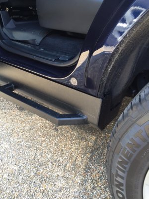

5Dpatrick
Oct 7, 2014
15
I just had my 2015 factory installed side steps removed and replaced with T4x4 Sliders. I am in an apartment for few more months with no tools or work area, but I have a "Guy" He removed the steps and installed the sliders and without getting into detail said it was a much more technical job on this vehicle than earlier model years. He has been working on Rovers of all kinds for many years, and has done this job countless times in the past. These steps are not your fathers steps...so to speak.

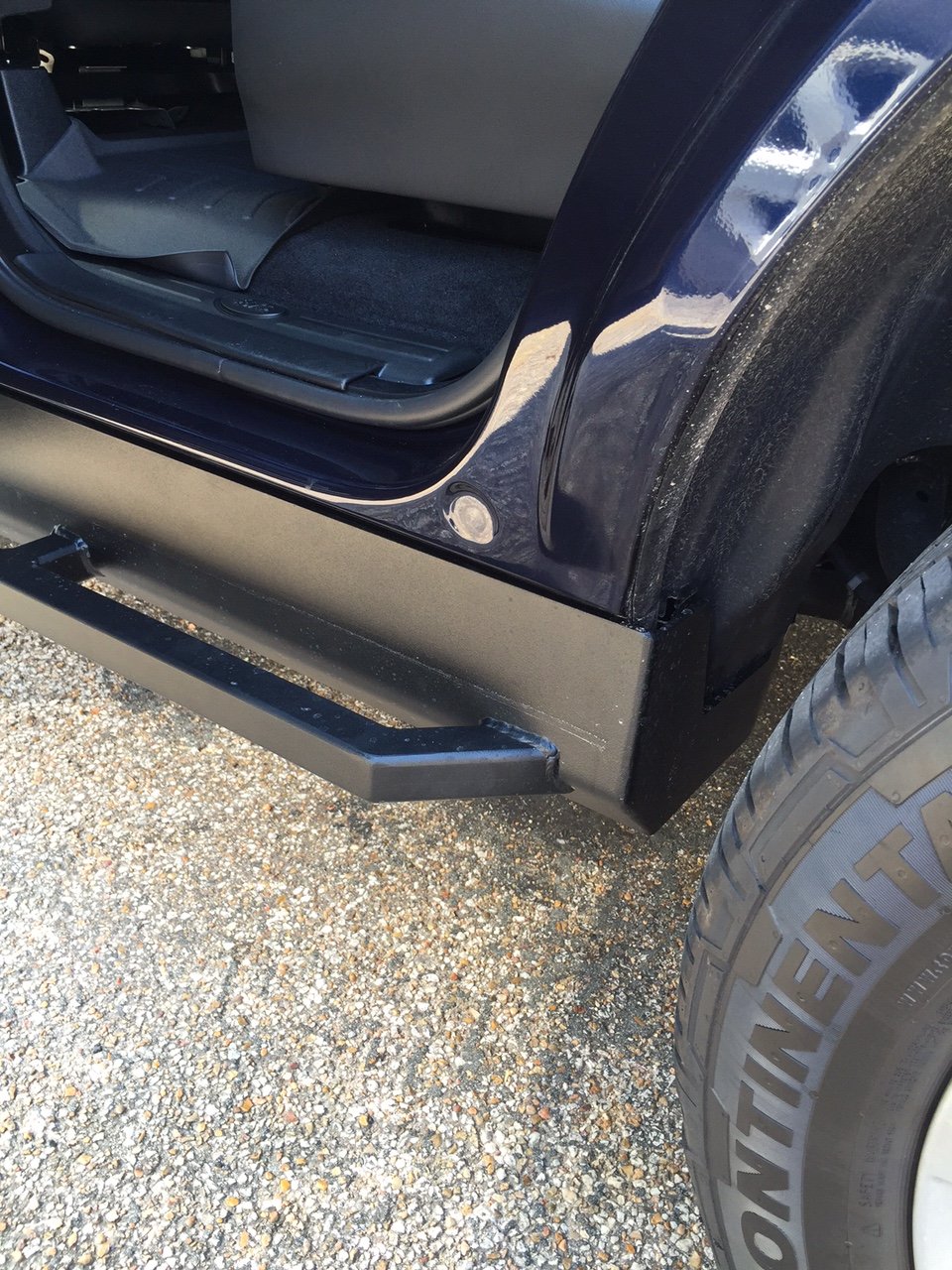

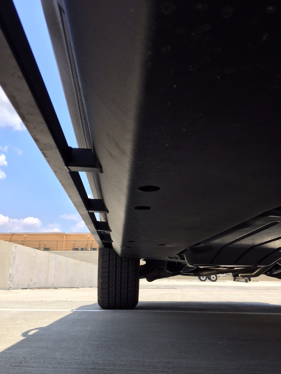

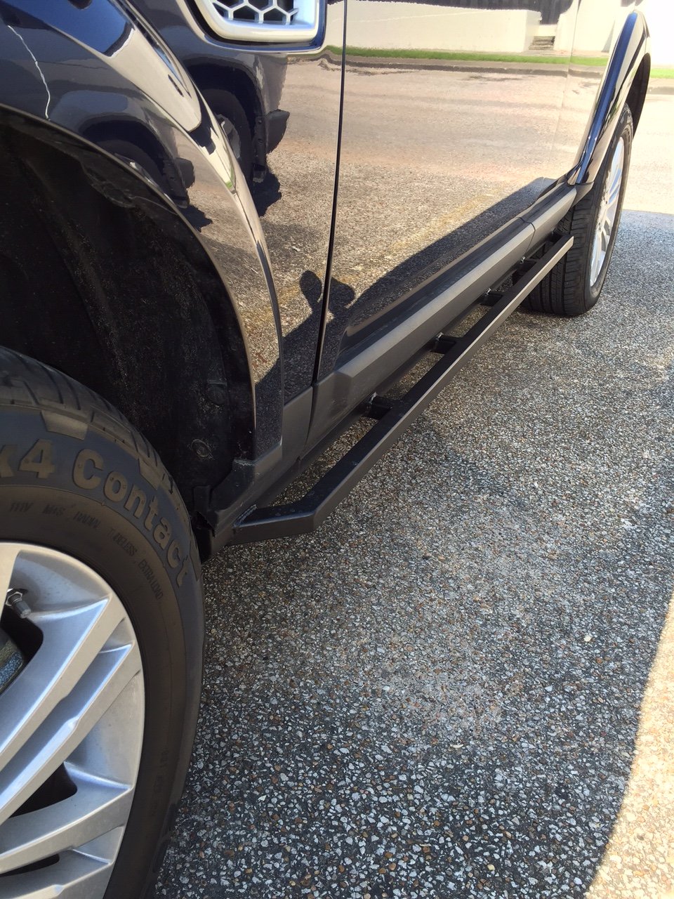

5Dpatrick
Oct 7, 2014
15
Some pics, underside, door sill and side view of my Tactical 4X4 sliders.
