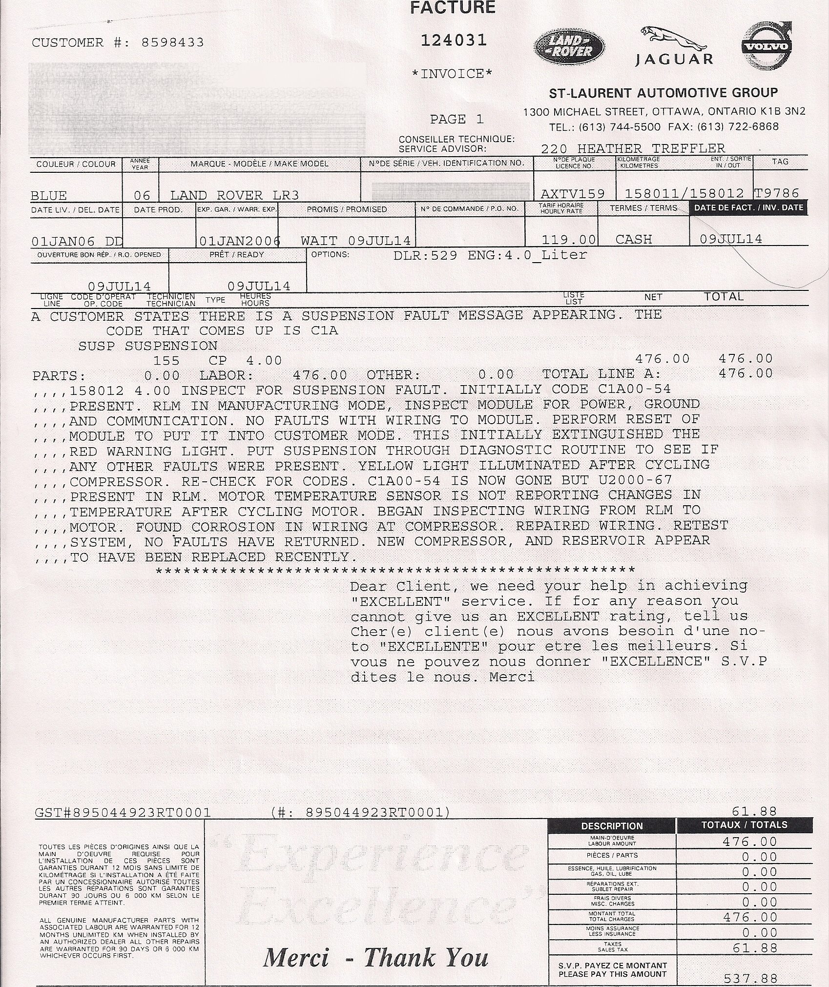

Greg9504
Feb 6, 2015
32
Ottawa Ontario Canada
I got the service history from the previous owner of my LR3, here is one that sounds similar. Give it a read see if it helps. Basically bad wiring. Are you able to read the exact codes? I'd get a IID tool...
