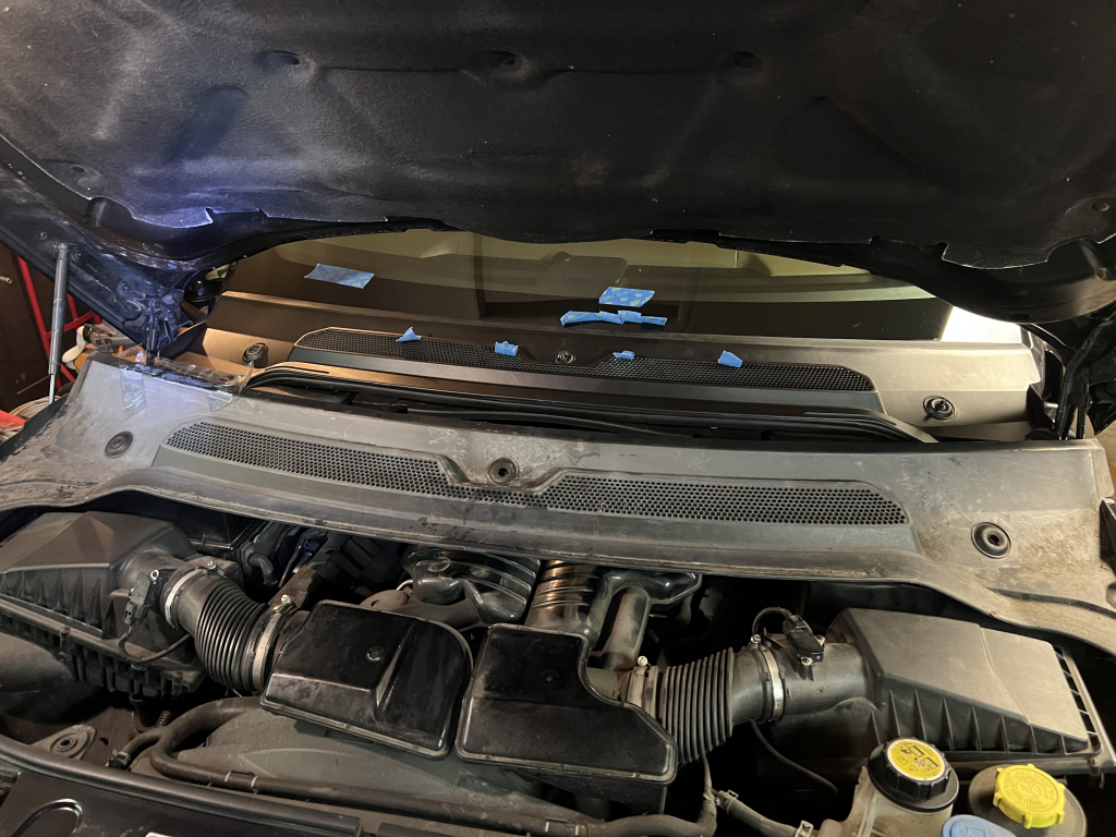

  • Rear third brake light is cracked and was leaking watering into the tailgate. I've got it sealed at the moment with 3m clear protection but plan to replace it on a warm day so the windshield sealant cures correctly

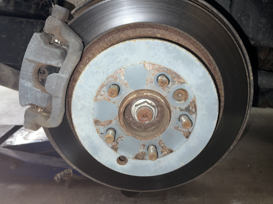

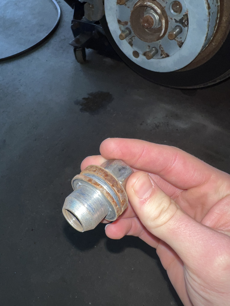

  • Front tires replaced, rear tires not. Have two matching tires coming for the rear, but lugs on back axle are swollen like crazy!

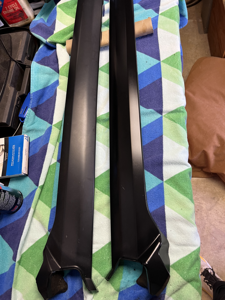

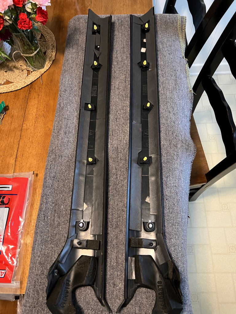

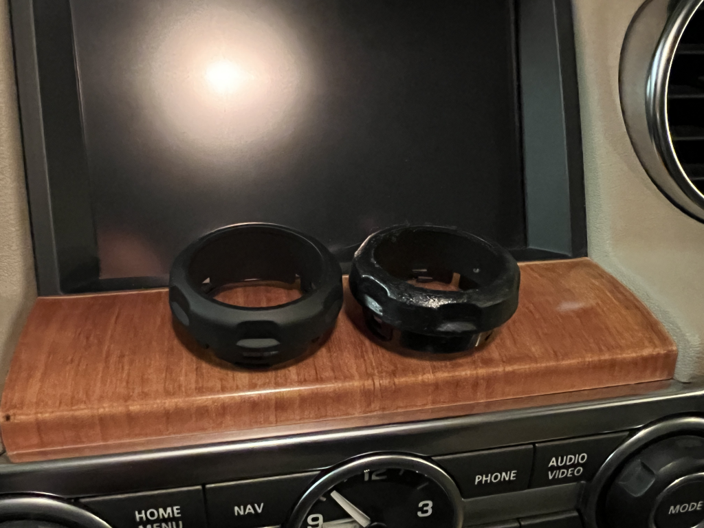

  • Replaced the trim clips holding the exterior A-pillar plastic on, now much more secure. No more noise at highway speed. Added extra weather stripping to limit water ingress.
  • Replaced the lower windshield cowl, as it was leaking and gross looking (and cleaned out all the gutters around the windshield, lots of debris from being street parked underneath a tree)

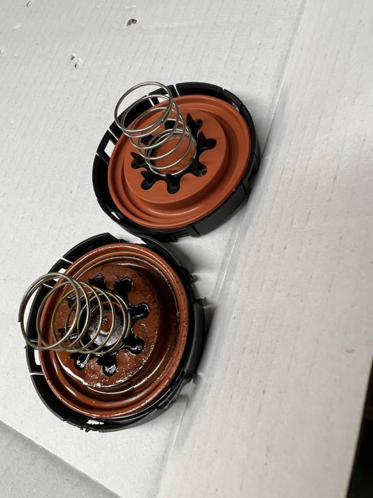

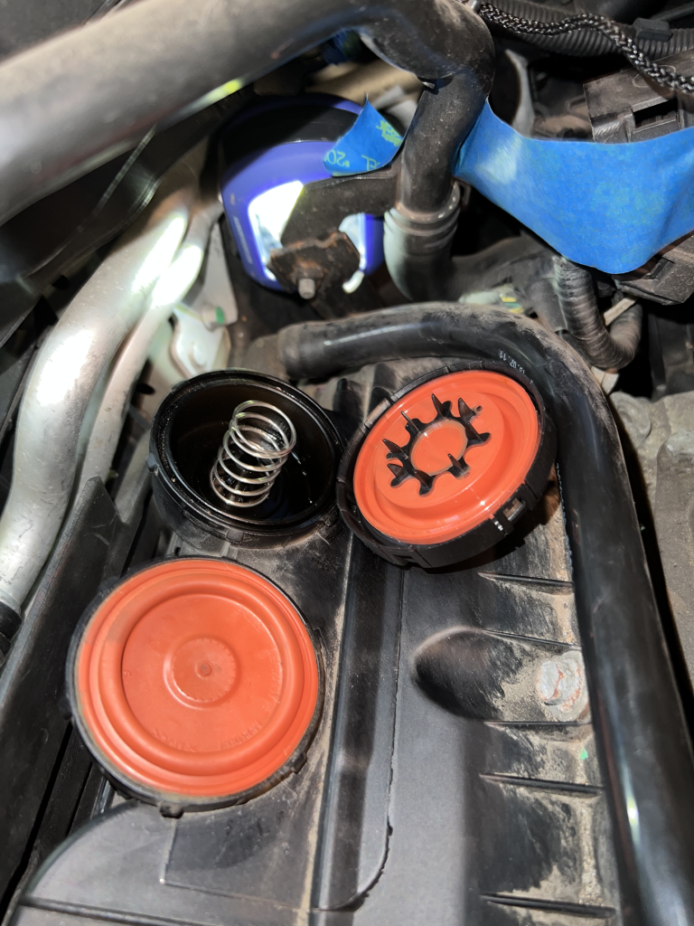

  • Replaced the PCV values as preventive maintenance

  • Replaced rear tires and ordered new lugs for rear axle (old lugs were swollen and rusted)

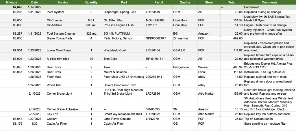

I’ve recorded everything down to the cent, so excluding auction fees and tax (as I would have paid that to a dealer anyways) I’ve got $15,370.83 invested with the above maintenance. Now that leads me to my question.. Loss of coolant / preventative maintenance…
I’ve got a reputable indy shop (specializes in LR, Columbia MD) that will refresh the entire system minus the radiator for at most $2,500. Will likely be between 2200-2500 is what I was told. Or I can buy all the parts OEM for around 1,100 (including WP, crossovers, gaskets, radiator hoses, thermostat, etc) and do it myself. I’m a DIY’er but I’m hesitant to overhaul the cooling system as these 5.0 motors are so sensitive to overheating. I also want to get it done within the next month or two and I don’t know if I’ll have the time.

What did you clean the black A pillar trim with? Looks good by the way!
I saw that LR4 on Cars and Bids and it looked like a pretty good deal.
Back to black - won’t lie after a few rain runs it’s starting to wear but at this point it still looks better than it did

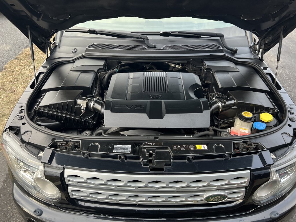

Cleaned the engine bay today, never been a fan of tire shine where dust accumulates but in this case it was worth it, as the black plastic is looking new once again.
2,622
1,283
Looking good. Check your voltage for that weird warning light episode

Edit: Almost forgot, swap out swollen nuts to solid 1 pieces. Something like this, https://a.co/d/69jJLmF.
I hope you're having fun with all this cleaning, it's really having a great impact :). I used this stuff in the past for restoring plastic, it works well and lasts a reasonable time:
Can you comment where you got the plastic clips for the A-pillar, I get some wind noise on the highway and would like to clean and reseat my covers. I found these these:
They are a different model number and price from what you posted in your excel spreadsheet???
Thanks.
