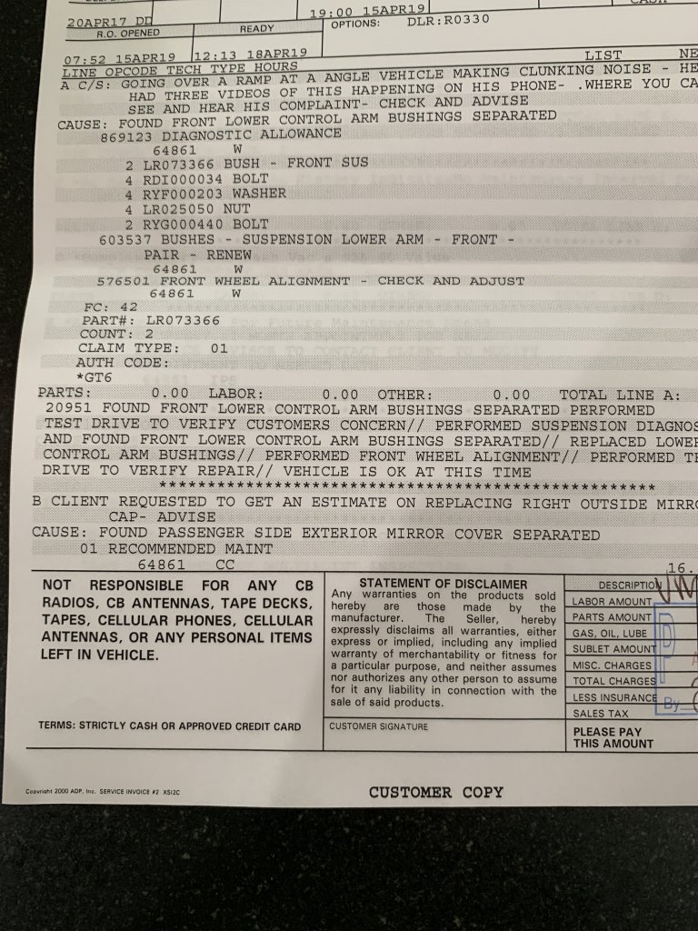

we have a 2015 Land Rover lr4 that has made a persistent clunking when traversing ramps or curbs at an angle. For example, if you pull out of our driveway that has about a six inch ramp drop to street, there is a clunk that seems to come from front. Dealer replaced front bushings under warranty, saying they had separated. LCA fine, as were tie rods.

What front bushings were replaced? The rear lower control arm bushings are the likely culprit.

You mentioned LCA were fine? I doubt dealer pressed new bushings into the LCAs
See invoice attached of work done
2,634
1,295
Wow they did just the bushings. No problem as "vehicle is OK at this time" lol

Looks like they just replaced the fronts. Most likely, the rears need replacing too. Also, wonder if the ball joints themselves are going bad. At this pt, might just need new LCAs.
Part number shown (LR073366) is for the rear bushing of the front control arms, which AFAIK is the one which usually wears prematurely and causes clunking.
