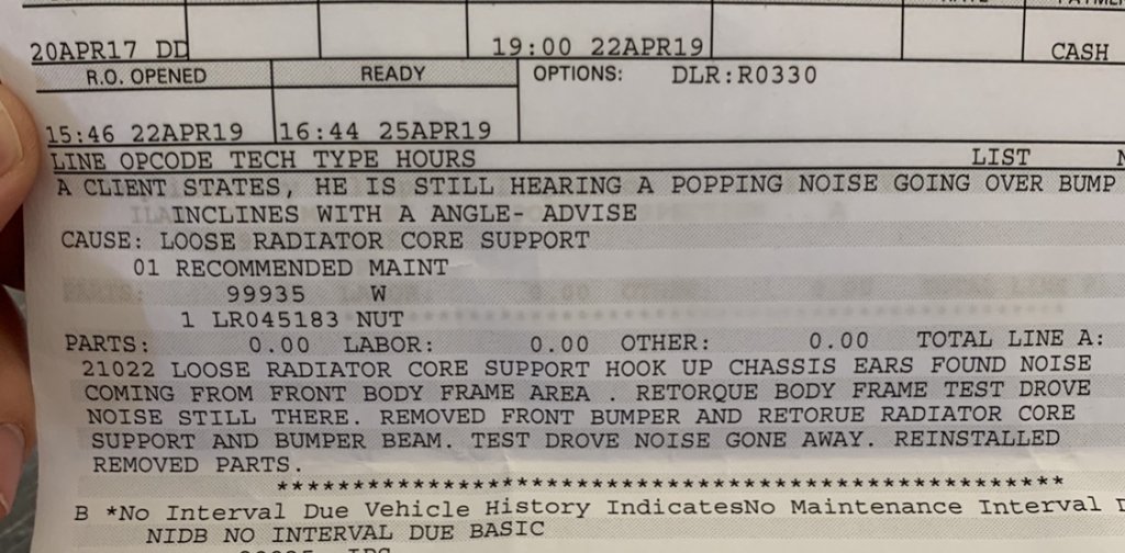

Mystery solved...loose radiator core support. Bolts tightened and knock is gone.
