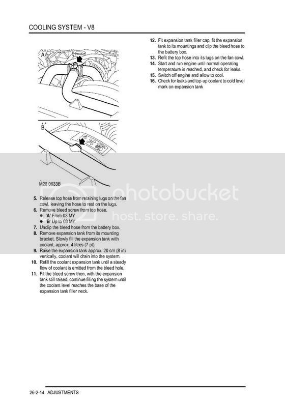

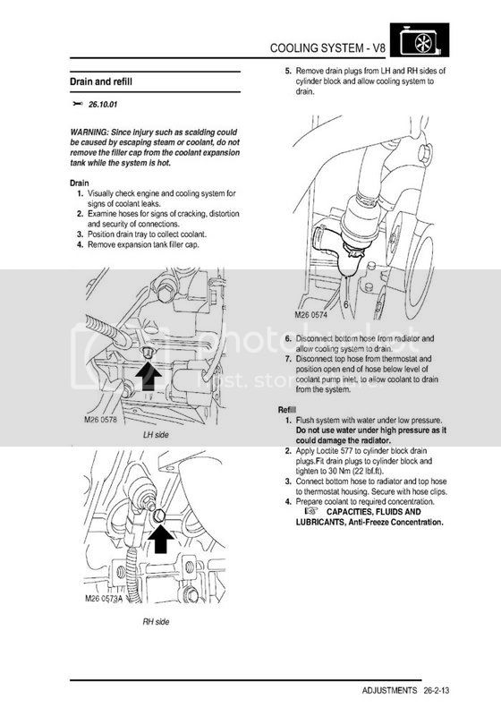

thanks but what is the best way to bleed the system to get the air air out of the system.

Most systems have a regular valve to adjust the flow to the heater core to control the temp. Most are cable controlled and some come off or snap.
218,352
