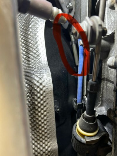

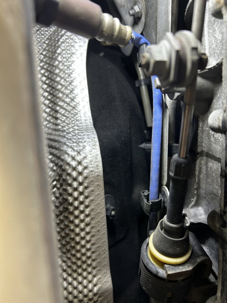

Found a puddle under my 130K mile LR4. Coolant was dripping from the front of the transmission pan. Local Indie shop diagnosed it as rear crossover pipe failure and repaired it. I hadn't lost much/any coolant and considered myself lucky.
Since the repair; I've noticed dripping in the same location while the AC is running. The condensate is dripping mostly on the PAX side of the transmission with a little on the driver side also. Is it possible that the AC drip line was displaced during the repair? Or is this a symptom of a clogged AC line elsewhere (inside the cabin perhaps)?
I guess I'm trying to visualise where the drip line runs. Thanks!
