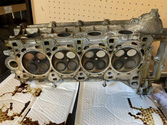

I was dealing with almost exactly the same issue, except on Cylinder 7. I changed plugs, injectors, swapped coils, walnut blasted the intake valves in hopes of fixing it. I then had a leak down test which confirmed a leaking exhaust valve on cylinder 7. I also had the shake while idling but no noticeable issue when driving. I could confirm with the Gap Tool that misfire would stop as soon as rpm's were raised above idle. If you have a way to check live values I would imagine you're getting a constant misfire on idle, then on the subsequent startup it throws a CEL because of the P0316 code. I'm currently in the process of tearing the motor down to have a valve job done. This is what the passenger head looked like when removed.
How many miles do you have on the engine? I had a very small shake at idle (No CEL, no misfires) but it has since gone away. I'm running a few bottles of Sea Foam through my fuel system and might do the intake version as well... but having a valve stick sucks... I'm at 94k miles.
