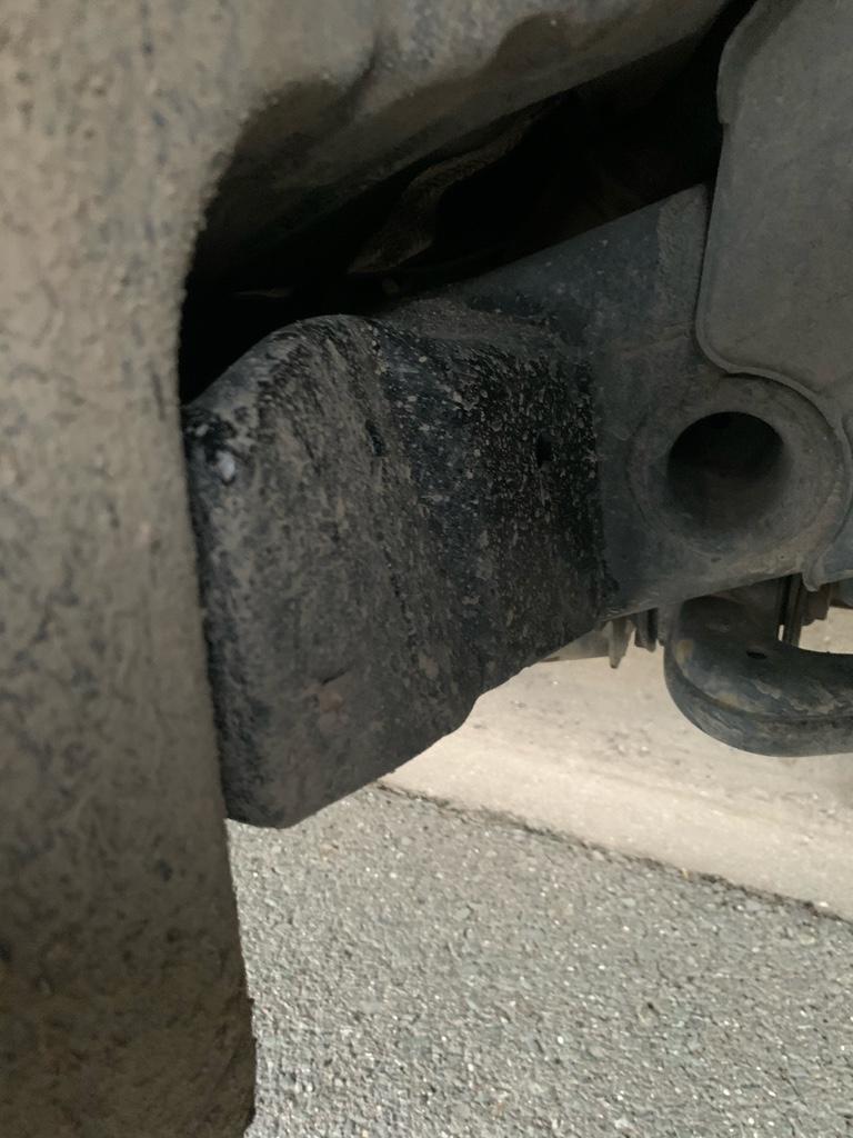

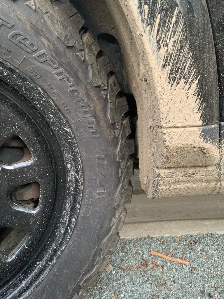

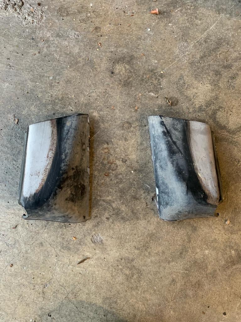

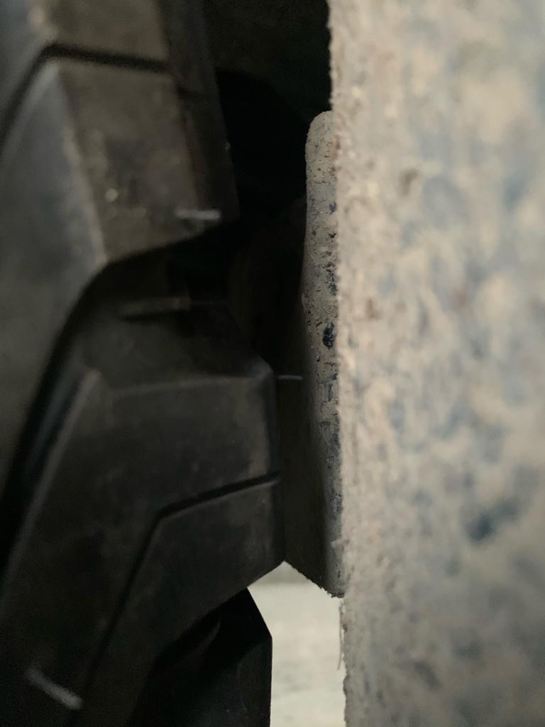

Hey quick question cutting the frame horns (I have some running as well) will that change and reduce frame stiffness or strength? Once cut I would also worry about the debris dirt, water that gets logged in the area. Any thoughts, can you take pictures of the cuts themselves?
Running 275/65r18
Needed to cut the frame horns as I experienced significant rubbing at full lock.
Got the frame horns cut flush with the wheel well. Excuse the dirt in the photos.
At full lock:
I just welded a small plate/patch over that area and rattle canned it to prevent rust. Can't speak to the frame "changes" but I highly doubt it would have any impact on stiffness or strength. Might have some impact on tire entering footwell in an offset crash but that is hypothetical at best. Definitely a "do at your own risk" kind of thing.
edit: I'll try to find some pictures I collected over the process....
