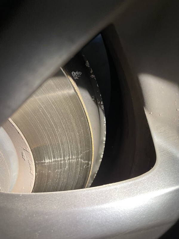

In the past 1000 miles I've been hearing a "humming" noise coming from the front of my LR4. The noise is more noticeable on the driver side.
No odd vibrations, shaking wheel, etc..
I've suspected my wheel bearing was acting up, so I jacked up the vehicle and checked all wheels for play. I found no play in any of the wheels.

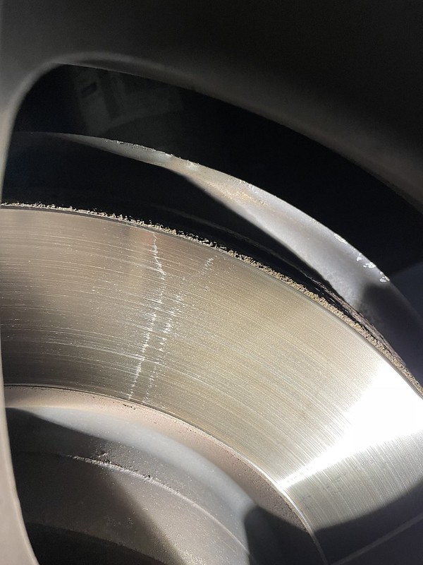

While checking the wheels I noticed my front passenger wheel had more brake dust on it than the others, by a far amount. Without taking the wheels off I noticed some irregularities on the face of the front passenger caliper.
Can anyone help diagnose what would be causing that? Sticking caliper? Caliper pins?
These are all different areas of the same rotor:

Sticking caliper or caliper pins. Hard to know until you take it apart.
But others here have had issues with sticking caliper pins, especially people in colder climates with a lot of road salt.

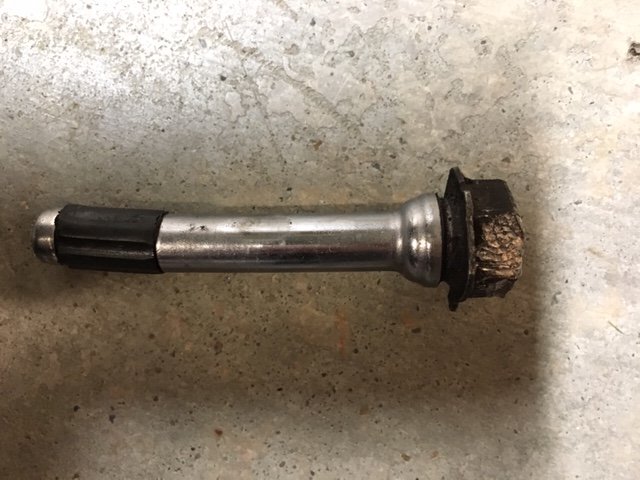

2,632
1,294
Clean and relube pins yearly with sil glyde or you end up with this. And no stuck pins were not easy as the calipers had to be removed to work on the pins on the bench. When putting pins back remember: Bushing pin on the bottom.
Well shoot, I think mine were on top and I put them back where I found them...
I'll have to take things apart again and rectify that! Does anyone know why exactly they go on the bottom? I'm googling it, but it's mostly just people asking the same question, then lots of guesses and "it doesn't matter" talk.

Ok I found this video which says that rubber piece on the pin is an "anti-rattle" mechanism, and can sometimes swell up and cause the pin to get stuck and can lead to uneven brake pad wear. Guy in video says he removes them, which I didn't (and probably wouldn't) do. If its only function is to prevent rattling (which I'm not hearing or experiencing in mine), as long as it slides freely (which mine do), I'll probably leave mine where they are until I change the rotors and pads.
