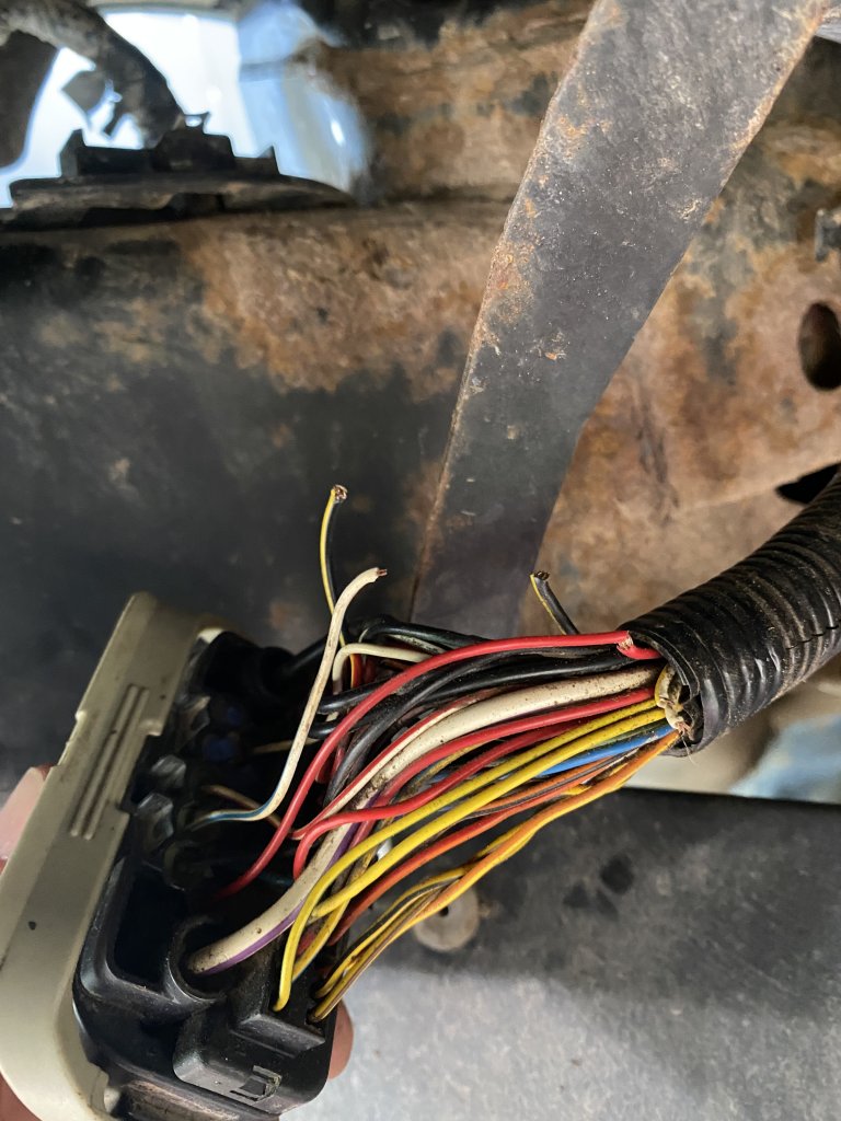

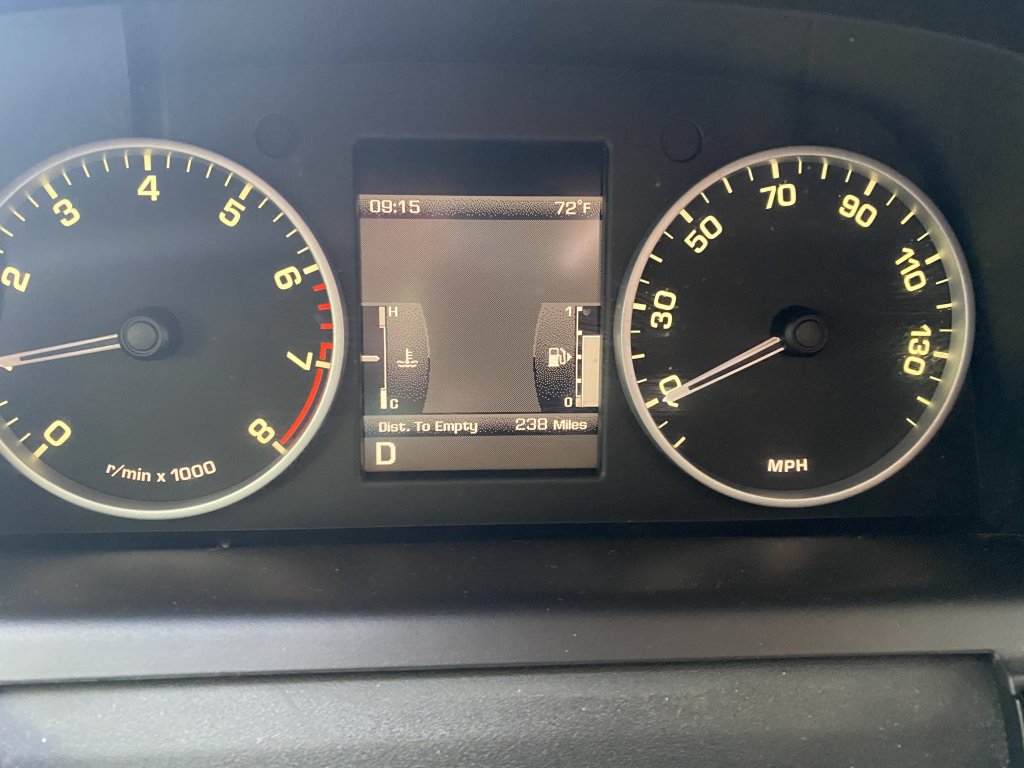

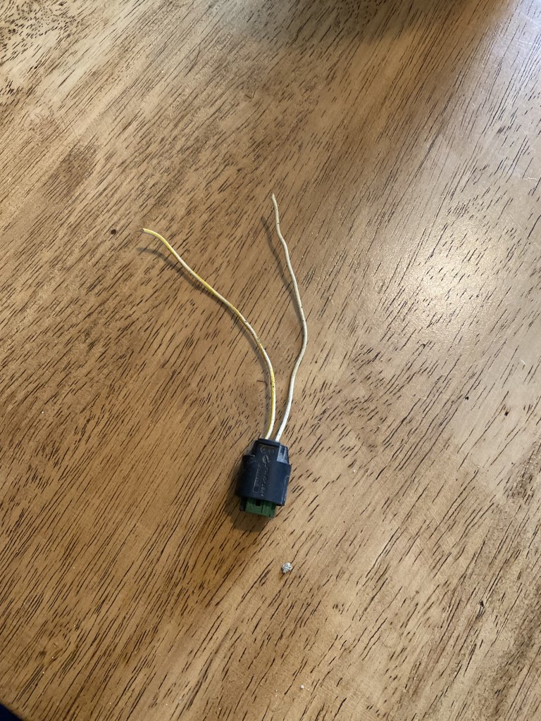

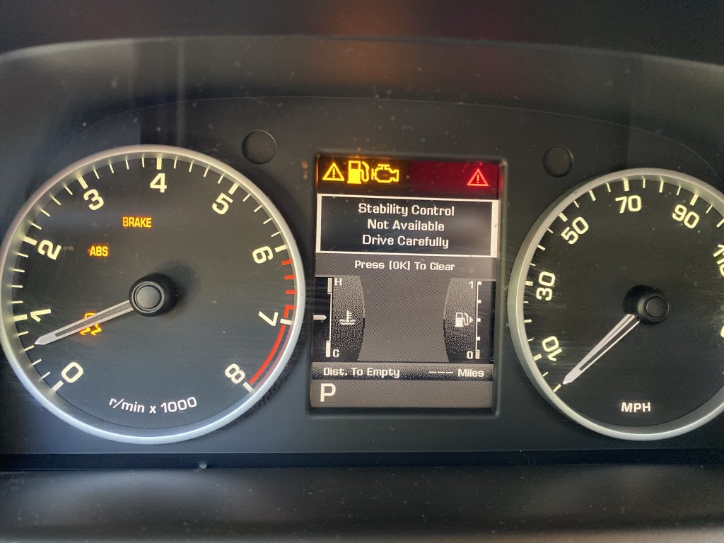

Solved the issue. A few weeks ago we had heavy rain. Sunroof clogged=flooded floorboard. Lights galore. Thought it was flood damage causing the lights so I took it to a shop and filed an insurance claim hoping to total then buy another LR4. Diagnosis says water didn’t cause the lights, a wheel speed sensor was causing it. All of this and the fuel tank level is still not working. Anyway, because they wanted $100+ for a $25 Bosch speed sensor, I decided to fix it myself. When I went to unplug the old sensor, the entire connector broke off of the harness. Look at the harness and there are FIVE OTHER BROKEN WIRES.
Removed the spare, got my soldering gun, then got to work. Couple hours later after they all got soldered back up, no lights, no codes, air suspension raised as normal, and my fuel level is registering on the cluster.
I’m back baby.
