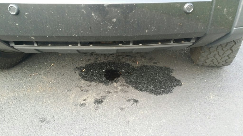

"Ghost" leak
CMGRover
May 1, 2010
834
Past week I've noticed a small oily spot under the LR3...about an 1.5" in diameter. Coming from the middle of it. I just got under it and the crossmember that runs between the transfercase and the transmission pan has a wet spot on it, but both the tcase and trans pan look completely dry. And it hasn't leaked for a few days.
Any ideas?

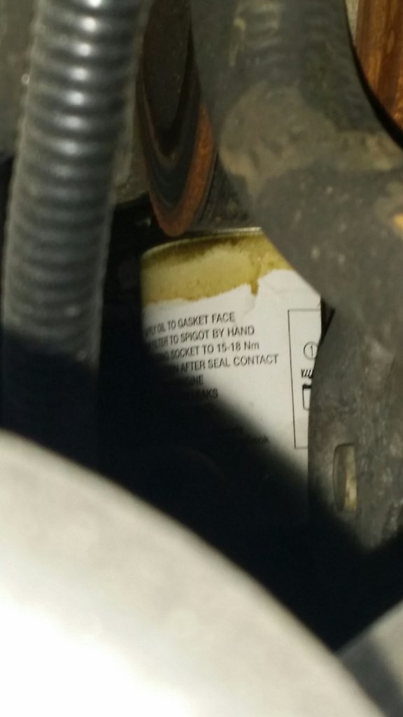

Finally got into the shop and.......the culprit was a leaky oil filter.
catman
May 4, 2015
699
I had the same issue earlier this year with an OEM oil filter. Started leaking for no reason about 4,000 miles thousand miles after installation.
