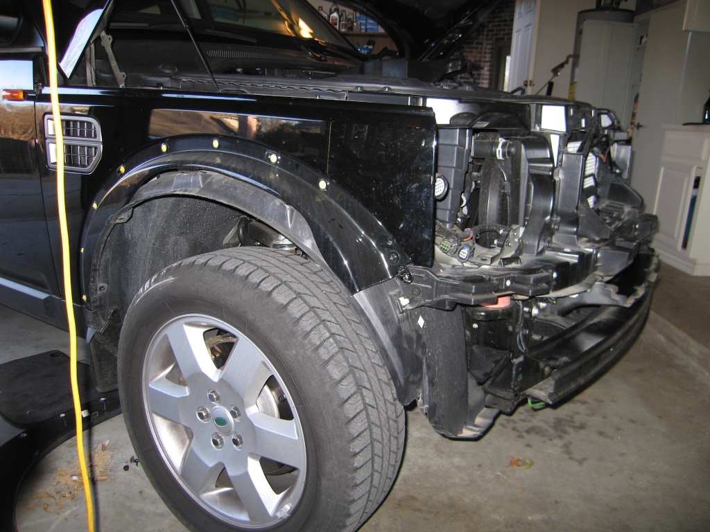

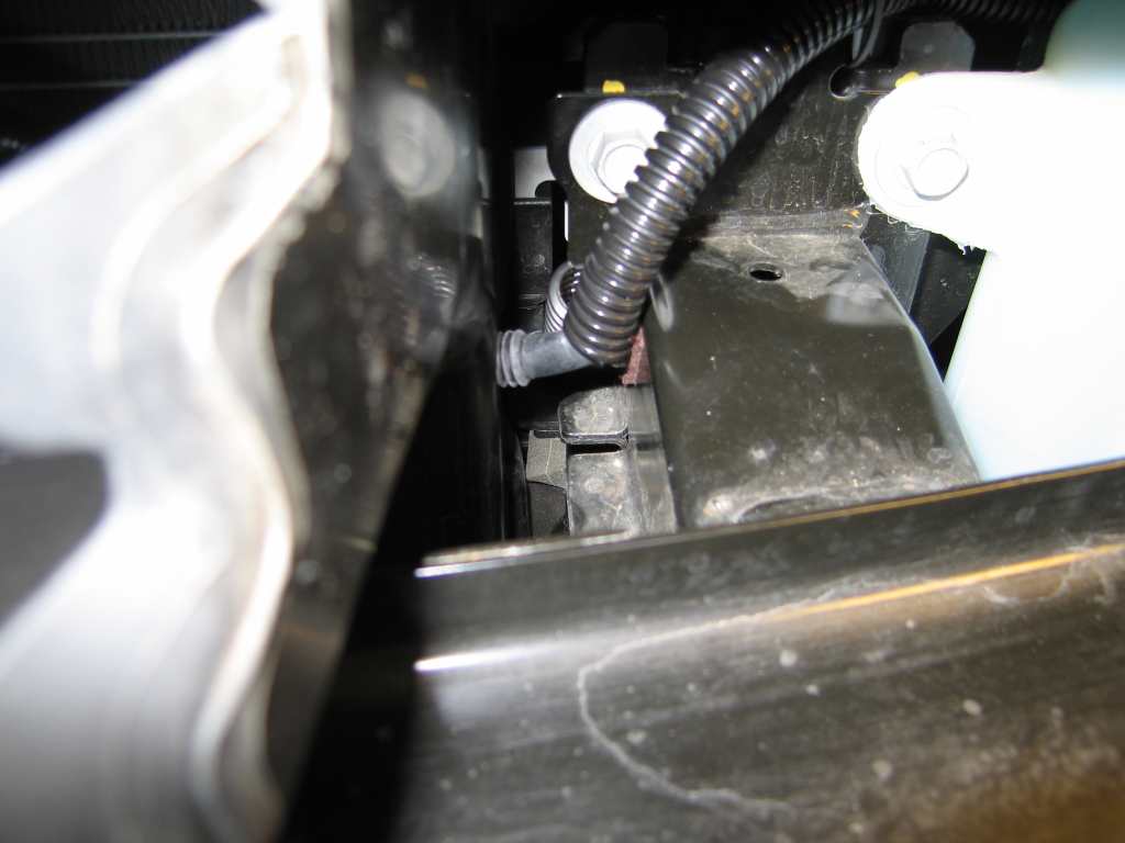

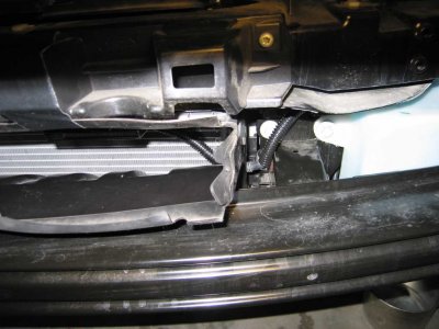

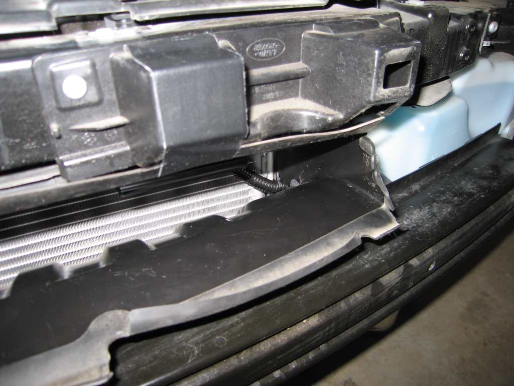

Yes, the front has three modules. A radar unit, and two laser units. The radar unit was relatively easy to install. The two laser units were more difficult. I had to take the bumper cover off, and some of the under cover shields.
Despite all the work and planning, the units look great. You can't see anything from the front of the truck. The radar unit is behind one of the plastic main grill bars. (The grill comes off with about four clips in about 10 seconds by the way.) The laser units are back in the lower grill area, below the bumper, in the scoop area that brings air into the lower part of the radiator.

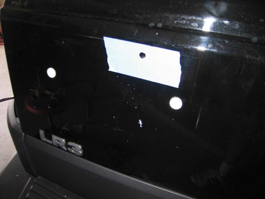

The rear was easy. It is a small license plate mount unit. I spent most of the time running the wire and ensuring a factory like install. I had to drill into the tailgate.
