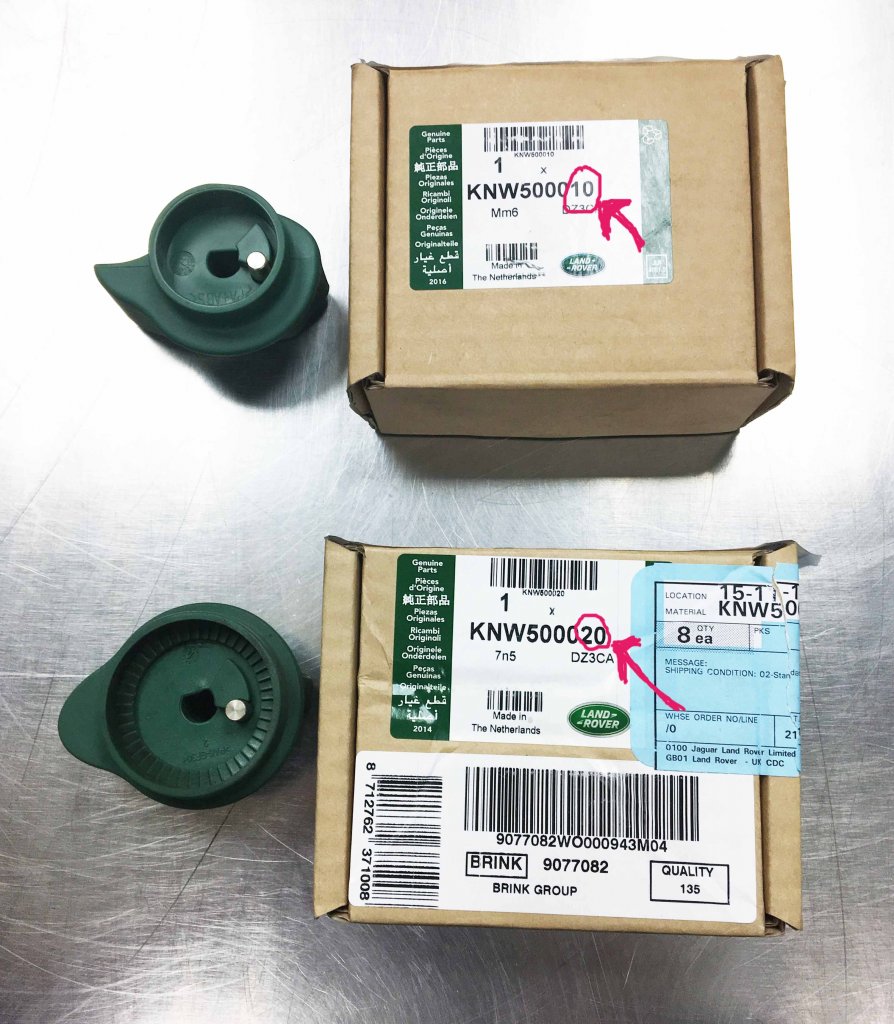

I'm missing the small red key that unlocks the green hitch receiver pin handle so the hitch receiver can be removed.
I went to my local Seattle Land Rover Dealer today and got some important information regarding these keys. Check out the photos for the size and model# information - The larger green pin handle has a "20" for the last 2 digits of the part# - Smaller green pin handle has "10" for the last 2 digits.
#1: Nobody in the USA can get a new key for anyone who has lost their keys.
#2: There are 2 different sizes of the green receiver pin - one model is larger & one model is smaller
#3: Fortunately LR Seattle had the larger green receiver pin in stock - Both pins are $34
The dealership was incredibly friendly and accommodating today - They removed the old green pin for me at no cost and installed the new pin. All I paid for was the new green pin which was $34. They also washed my car on the house.
Nice to have a new green pin with the 2 new red keys.
