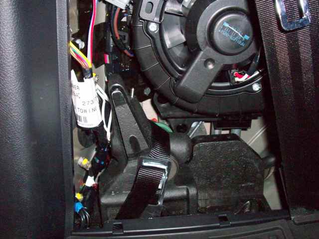

I bought a new to me 2007 LR3 HSE and the original owners ordered every bell and whistle for this thing. So I went to look into a hitch for it and noticed it came with the folding key for the factory LR hitch and its pre-wired but no hitch to be found. Is there a special storage spot for the hitch that I'm missing? I looked in the jack storage area and aside from the red plastic hitch insert, no hitch. Just hoping that's not the one thing thats missing...
Thanks!
A fully loaded HSE generally did not include the hitch insert nor usually the trailer wiring. If you do have the factory trailer wiring and not the hitch insert, then even if the previous owner left it in the vehicle, someone got to it before you did.
The special factory storage spot of the insert was the sort of styrofoam shape pictured that set into the driver side left access door on the rear side wall below the secondary HVAC fan.
I think you are correct that in the early years you could get the parts but it may not have really even been a line item "option" for a build order. Mine is an HSE that I bought new in spring 2007 but at same time bought the quick release "receiver" (I wouldn't call it an "insert" LOL) and the wiring which was fairly simple to plug in myself.

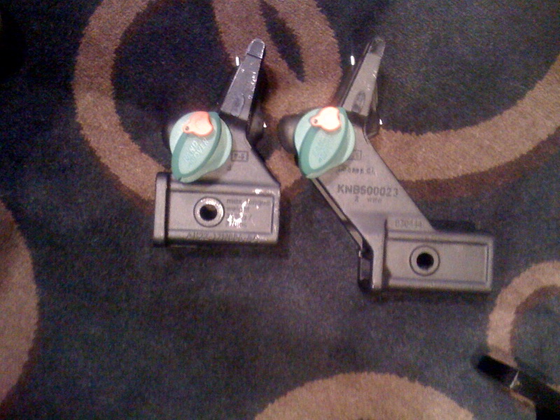

Yes, I guess it is a Receiver. The jpg shows the newer smaller LR4 type and the big one is the LR3 original receiver. The LR4 type fits the LR3 and hangs down less - looks better as well.
Yep. I have both. Sometimes the low one works better because it's pin point is further out. This is probably only an issue for me because I have the rear tire swing arm carrier and a trailer with fixed lowering crank can be too close. I like having choices!

View attachment 10508 A fully loaded HSE generally did not include the hitch insert nor usually the trailer wiring. If you do have the factory trailer wiring and not the hitch insert, then even if the previous owner left it in the vehicle, someone got to it before you did.
Thank you! This is exactly what I was looking for. So while the original owner did get a ton of ad-ons including the iPod dock on the dash and USB aux hub in the glove box, and this LR3 still had every accessory like the bag for roof rack rails, all of the documents, and factory hitch wiring, there is no sign of the factory receiver hitch in the rear HVAC area. Bummer. Guess I'll have to order one...
