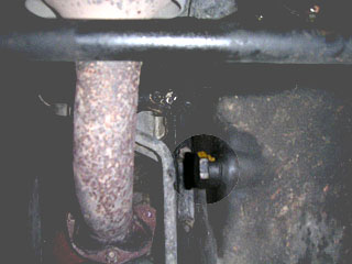

2. Under the Land Rover you will see a large tank with a bolt protruding from the side of it. This is the oil tank with a (cough) well designed discharge bolt.
3. Place any small pan (only a few bucks from your local parts store) under the discharge bolt of the tank.
4. Remove the bolt slowly. Be careful or the oil will shoot out a few feet from where you put the pan.
5. Drain all of the oil from the oil tank into the pan. Be daring and let it fly! Catch the oil if you can. Otherwise let it drip slowly into the pan and be safe. Either way, you will get a drop of oil on your hands or clothes.
6. Screw in the discharge bolt, but not too tight that you round the edges of the bolt.

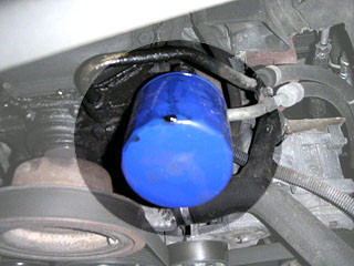

7. Now, locate the oil filter as seen below. It is on the bottom of your engine and is usually a white or blue color like below.
8. You can buy a filter wrench to remove the filter, which should be about a few bucks from your local parts store.
9. Use the filter wrench to rotate the oil filter to the left (righty tighty, lefty loosey)..
10. Remove the filter slowly and let the oil from the filter drip into the pan. You can touch a stick onto the filter and it will guide the oil down into tjhe pan.
11. Screw in the new filter using the filter wrench to the right (righty tighty, lefty loosey). Do not over tighten the filter. Once it makes contact, simply rotate it one more half turn.
