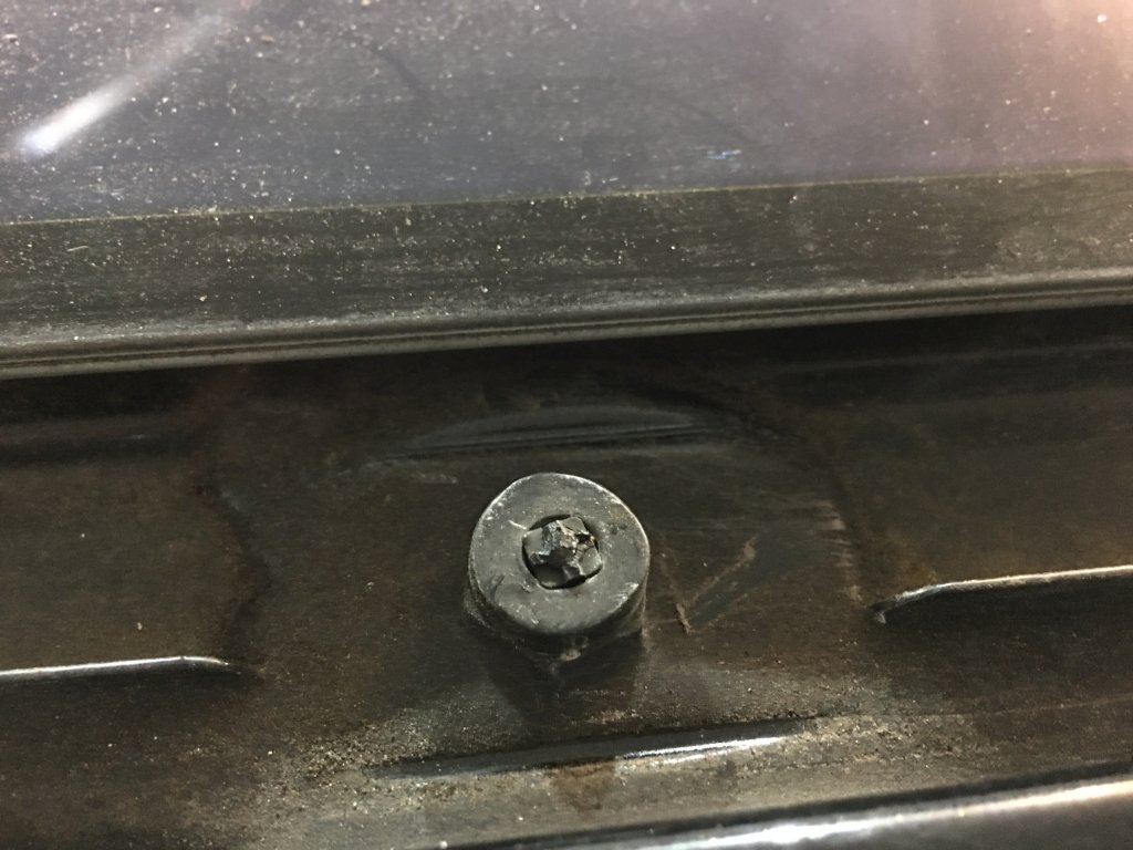

Did one side, no problem. The next side the plastic plugs rip the top off. Any help getting this out? They want to sink to the bottom of the hole.

I had the same thing happen to me. Pliers and xacto knife to scrape plugs out. Then, tap the threads to clean out the hole. In The 2013 model I have, the plugs were basically glued into the hole.

Thank for the help. I did the best I could clearing the holes. Ended up buying new M6 1.0-16mm bolts which are a hair shorter than the OEM. Worked well.
The OEMs are M6 1.0-20mm sized for anyone who needs to know.

JangoSW, I posted my experience and solution a while back. Hopefully this is useful to you or the next guy who needs to remove the rail plugs;
https://www.landroverworld.org/thre...astic-caps-securing-roof-ditch-molding.29200/
As far as getting those out. It's now a mess, but try my method above (even with a broken off plug) rather than drilling it out. When I did that (drilling) it made a mess of the hole, I still didn't get it all out, and I needed to retap the threads.
