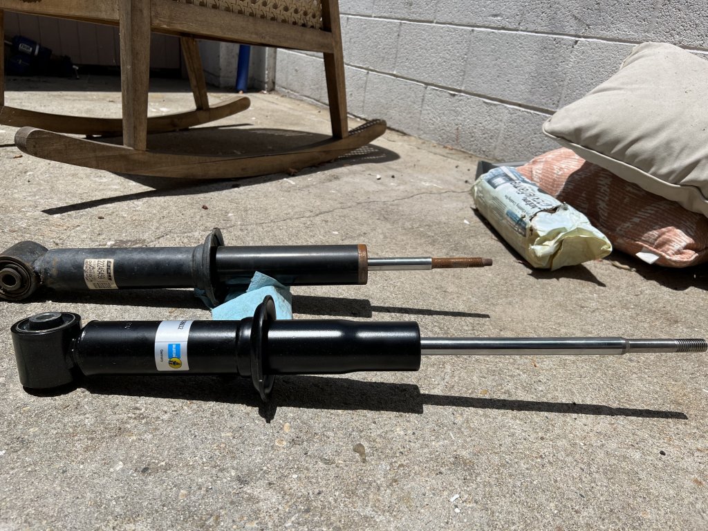

I've only heard that people are not a fan of the ride. They're Bilstein 4600 (yellow) shocks.
The (black) B4 are the replacement to oem+ spec, gas filled as opposed to fluid (I think). The yellow ones are uprated and quite a bit former, im not surprised they didn't like the ride.

I’ve a spare rear shock I’ll get a pic of for you.
Also don’t forget that there’s a bush at the bottom of the shock where it’s bolted to the control arm. These get tired as well….

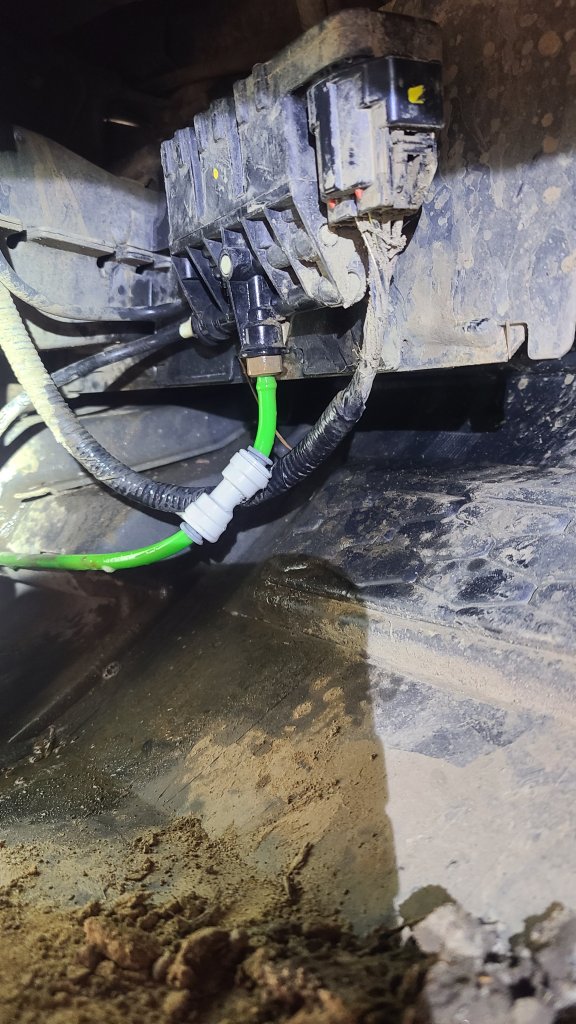

Joe77
Aug 18, 2021
41
Alberta, Canada
1/4" push connect union did the trick to repair the damaged air line. Quick and easy and air tight. When I have time I may revisit and replace the line but for now I'm pretty confident it'll work.
