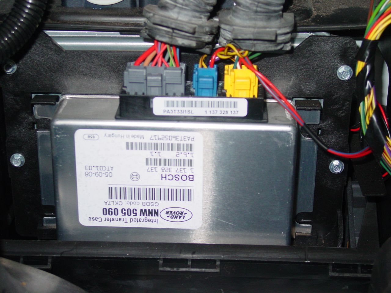

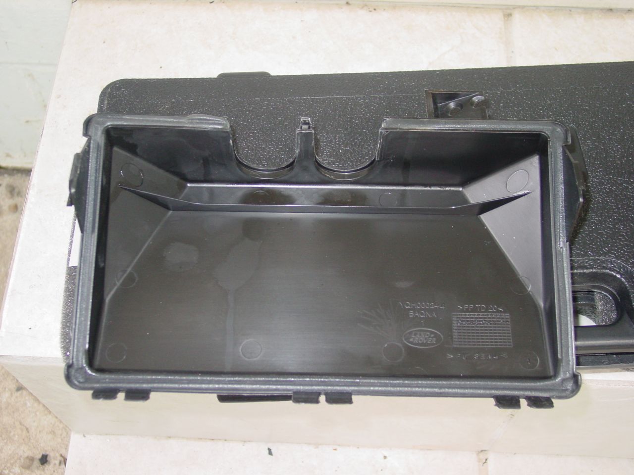

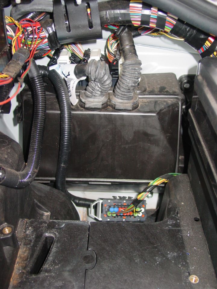

Attached are some jpg's of the automatic transmission transfer case control module, something you never want to know anything about.
Land Rover in their usual genius located it where windshield rain/car/engine wash water can flow onto it The rubber seal things on top are only for decoration - the back is wide open. Some wrap the rubber seals with a bit of black electrical tape per what you see but that does not solve the rear is wide open concern. Yes, put your battery cover back on and be careful when washing under the hood.
