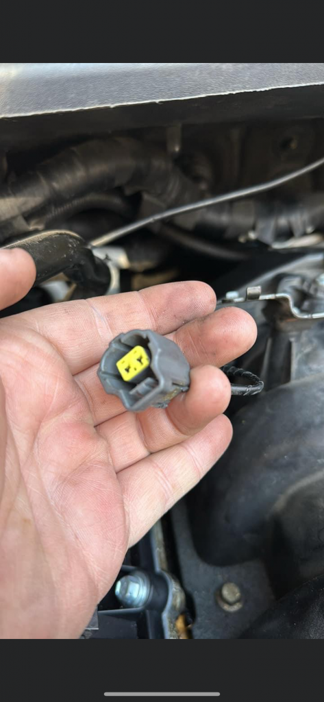

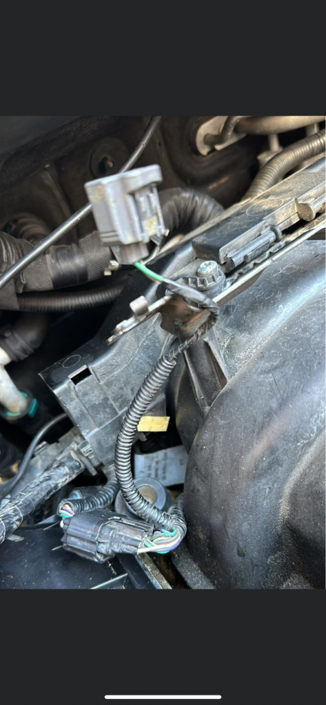

I know it’s been a little since this post was active but I’m doing the passenger side valve cover currently and I’ve run into an issue with reinstalling everything. I can’t for the life of me find where this plus goes. Any help is appreciated!
2011 Lr4 5.0 v8 HSE
