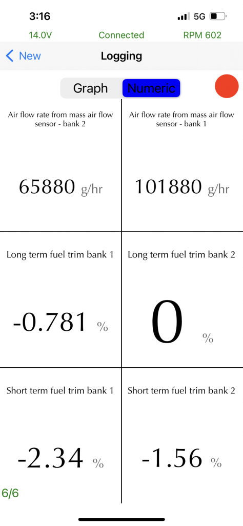

Well, its about 50F this morning and I refuel from almost empty and the truck runs rough has a weird 2-3 shift and then stalls almost a minute later as I'm coasting downhill. Restart, get the reduced performance warning. I plug my GAP tool in:
random misfire on startup, misfire in cylinders 1,3,8 (and the two EVAP codes which I'm not touching should be unrelated and I'm not worrying about until my fuel pump cover recall is done.. lol).

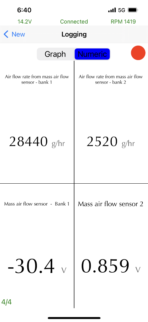

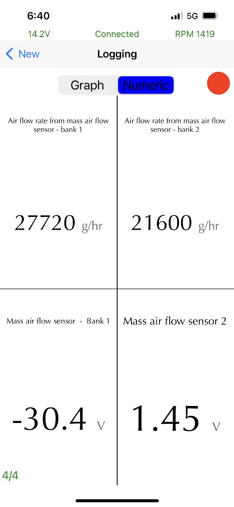

Anyway, there is a real discrepancy between the two MAF sensors. Not sure why the GAP tool's RPM reader isn't working but those readings are incorrect.
idle:
light acceleration ~30mph
no throttle input, coasting
I have a new MAF sitting at home, which one is the culprit here?

apparently the voltage discrepancy is a bug in the ECU, GAP says to ignore it.

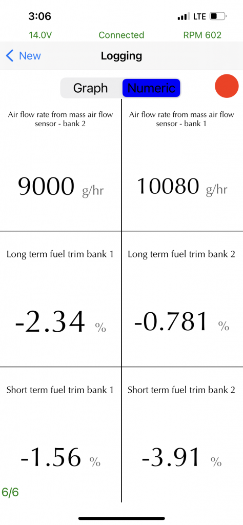

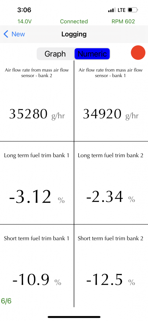

Idle and accelerating after resetting the codes on my way home. Seems normal?

When you look at fuel trims, you need to read short term and long term together. I would not be so quick to rule out the evap codes. I’m wondering if it could be a faulty purge valve.
Michael Gain
Dec 8, 2018
612
283
Clarksville, TN
100% accurate.
Even reviewing LTFTs that you provided show you're running rich. The ECU is trying to reduce the amount of fuel. Either the engine is getting less O2 than metered by the MAF, your intake air sensor and MAP is telling the ECU that the air is denser than it is, or your injectors are leaking / spraying more fuel than the ECU called for.
Since you have EVAP codes, I would chase where air is coming out... NOT a vacuum leak--as that would pull more air in and create a lean A/F measurement--you would see positive LTFTs and STFTs.

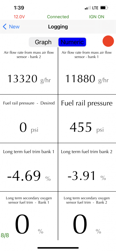

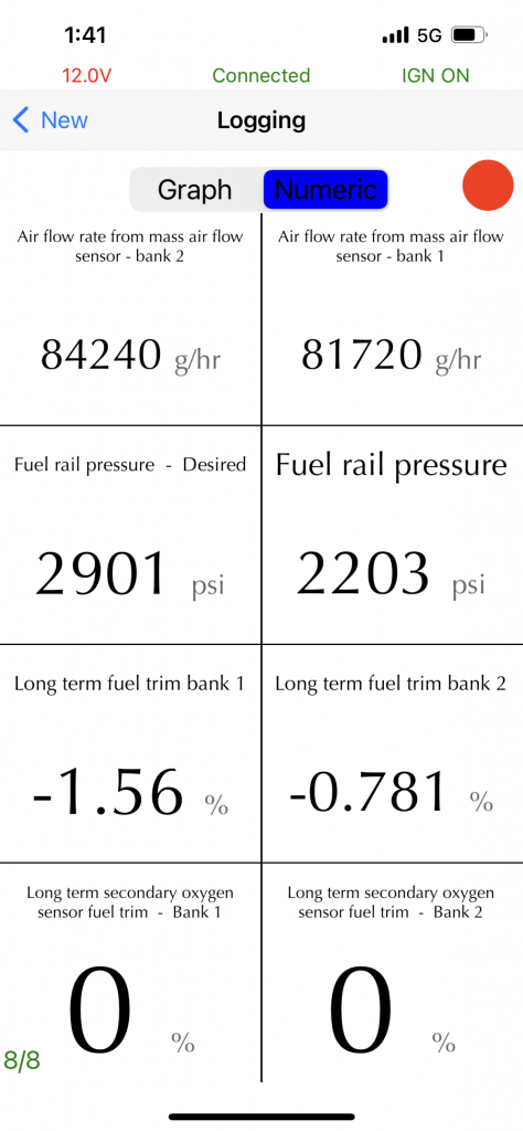

Not sure if these are the parameters I need to post, this sort of troubleshooting is new to me. First is idle, second is 2500rpm in park in the driveway, third is 2000rpm highway cruising at 70mph. Drove 40 miles one way, made a stop, 40 miles back. CEL has not returned.

If you are hearing an air leak at the pcv valves, it could be a torn diaphragm.
Wouldn't hurt to replace both. They are known to tear and leak.

The fuel trims are not terrible - just a tad rich at idle and cruising (but really pretty good), but it goes too rich at high idle 2500 rpm. Not enough to set off a light, but I’d say its outside of normal range at that one point.
Rich means not enough air (dirty filters), too much fuel (leaking injectors, rich EVAP canister), or a bad sensor someplace. Not sure about the stall with the special programs light.
Air noise near the PCV sure sounds like a torn diaphragm. I’d replace those and check fuel trims again. But a torn diaphragm will make trims go way positive, not negative.
