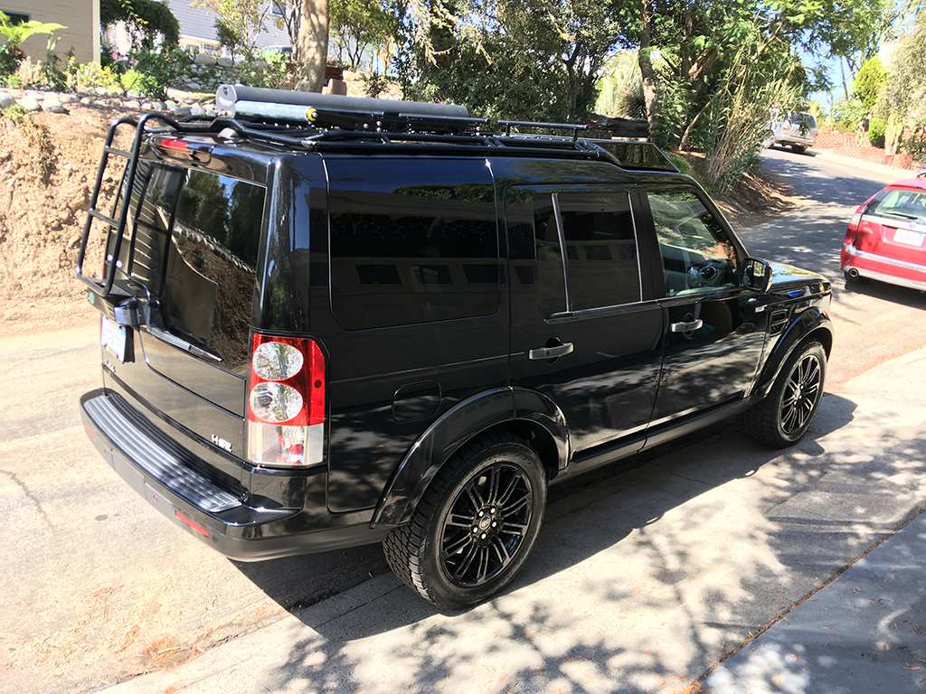

I'm hoping the knowledge base here can help shed some light on a mysterious tire fitment issue. After reading many, many tire threads, I decided to run nitto terra grapplers G2 265/50/20 on the oem ten spoke rims (2012 LR4 HSE). So all excited, I took the rims and tires to get fitted, rears went on fine, but much to my surprise the front tires would bump into the upper ball joint preventing a flush mount. Suffice enough to say, I had to give up, load the wheels back into the truck, and leave feeling pretty defeated. As I drove away, I noticed that the suspension had been set to off road height, not sure if this was an accident on the techs part, but I didn't have time to return that day and ask some more questions. I was hoping to run this setup as my daily driver and then order some compos for more adventurous stuff. Any ideas, thoughts on what the problem might be would be greatly appreciated.

Well, got them on after all. When I took it down to my Landy Guy, he said, which Jwest pointed out before hand, that since the car was on a lift and had not been Locked into access mode, the suspension kept reaching, making it hard for the tech to get a very heavy wheel flush with the hub. I have to say I love the way this set up feels for daily driving and camp/forest trails etc. Road response/handling is much improved, and still delivers that classic LR cloud ride. Next up, order a set of 18 compos, Install dual battery sys and add a fridge of course. Aux camp lights and rear tactical bumper with swing away might have to be in next years budget, you definitely feel the wallet drain with these beasts, but I just love this truck! HSE with HD package front and rear lockers, bought it last year with 32k on it.
