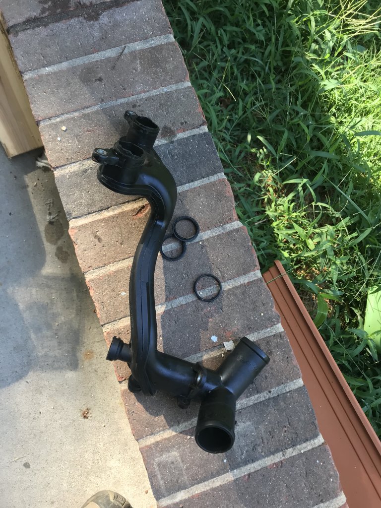

She is up and running. Trapped air was the fix. Also ran a can of sea foam through her to make her feel good about her new plastic she gets to work on destroying.
The two rings beside it, is where it broke.

Exactly like mine. Clearly a product defect. I would go so far to say replace this pipe ANYTIME the manifold is off for any reason.
BikePilot
Aug 25, 2018
184
72
Golden Colorado (USA)
Is there not an updated version that solves the problem? Porsche had a fit of insanity and speced plastic cross over pipes on cayennes initially but then when they failed the replacement parts are metal and seem to have put a stop to the failure for good. I'd have hoped that rover would do something similar. If not maybe an adtermaafte supplier could fill the void.
