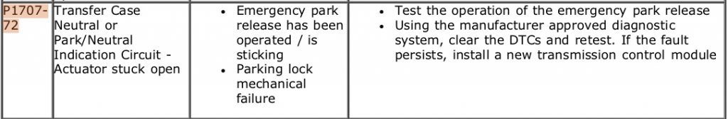

Just looked up the code in the manual. Seems to say it could be the parking brake release or the transmission control module. Pic of code description attached.
