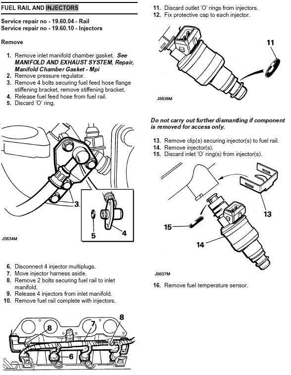

how about some more info on "the truck runs terrible?" as Joey says - you might have a royally screwed MAF (then - no amount of cleaning will work - you simply have to find a replacement that won't break the bank as the stock OEM is just plain silly in how expensive it is); try roverlandparts.com for some decent used MAF's & coil-paks.OK, The truck runs terrible, still the same code P0301, so I'm thinking it is an injector problem. How do I get to the injectors? Can I field clean them, or do I have to replace them?
