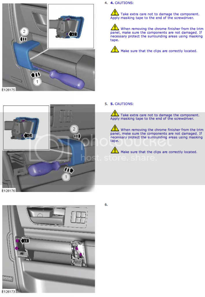

Does any one experience a rattle coming from their doors? I think it is from the contact of the wooden strip on the door. Does any one know how to remove the wooden panel so that I can insert some pad to muffle the sound? any help would be appreciative.
1,694

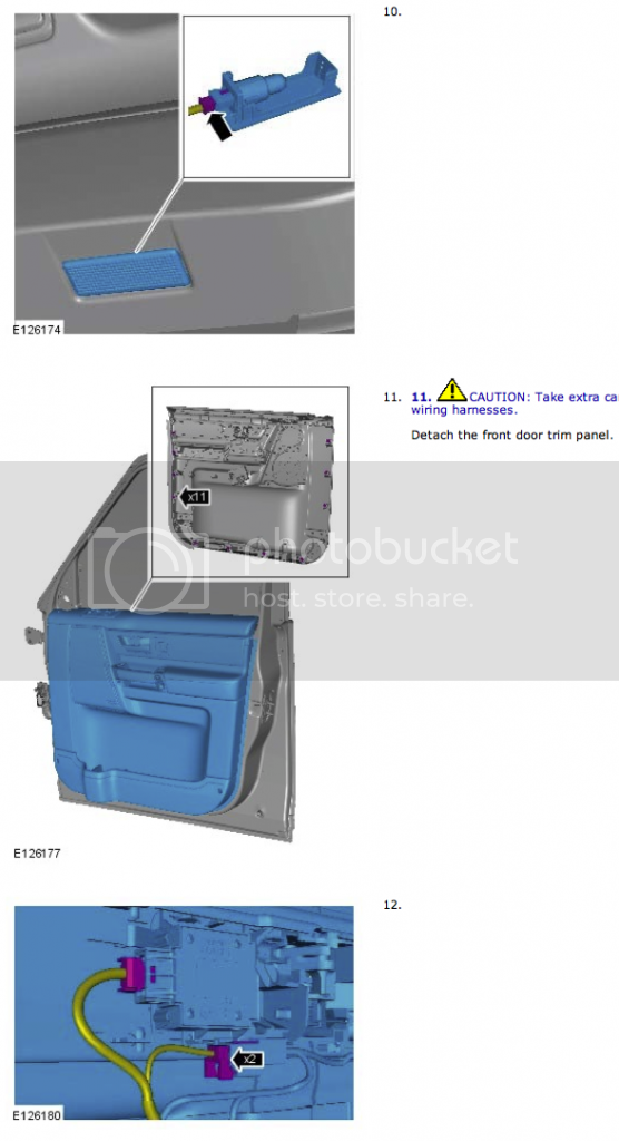

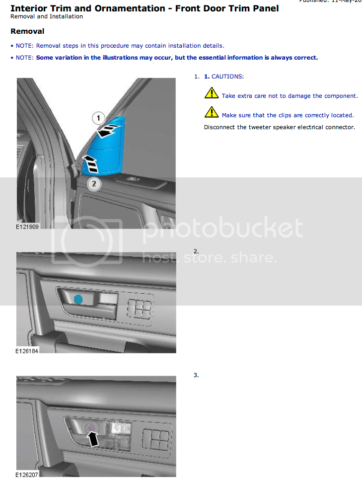

Here are the diagrams... hope they help.
That should get you far enough in to get the panel off.
