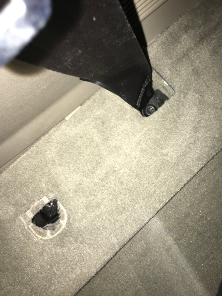

Seems like I need to remove the carpet layer above it? The bolt is hard to get to directly. Am I wrong?

Sorry, I had already started drinking for Saturday night. ;)
yes, you do need to remove the two flat pieces on either side of the cargo area. Remove the factory tie down points also with a t-50 bit, and they will then unclip with a little upward pressure.
You will then see the seat belt bolts.

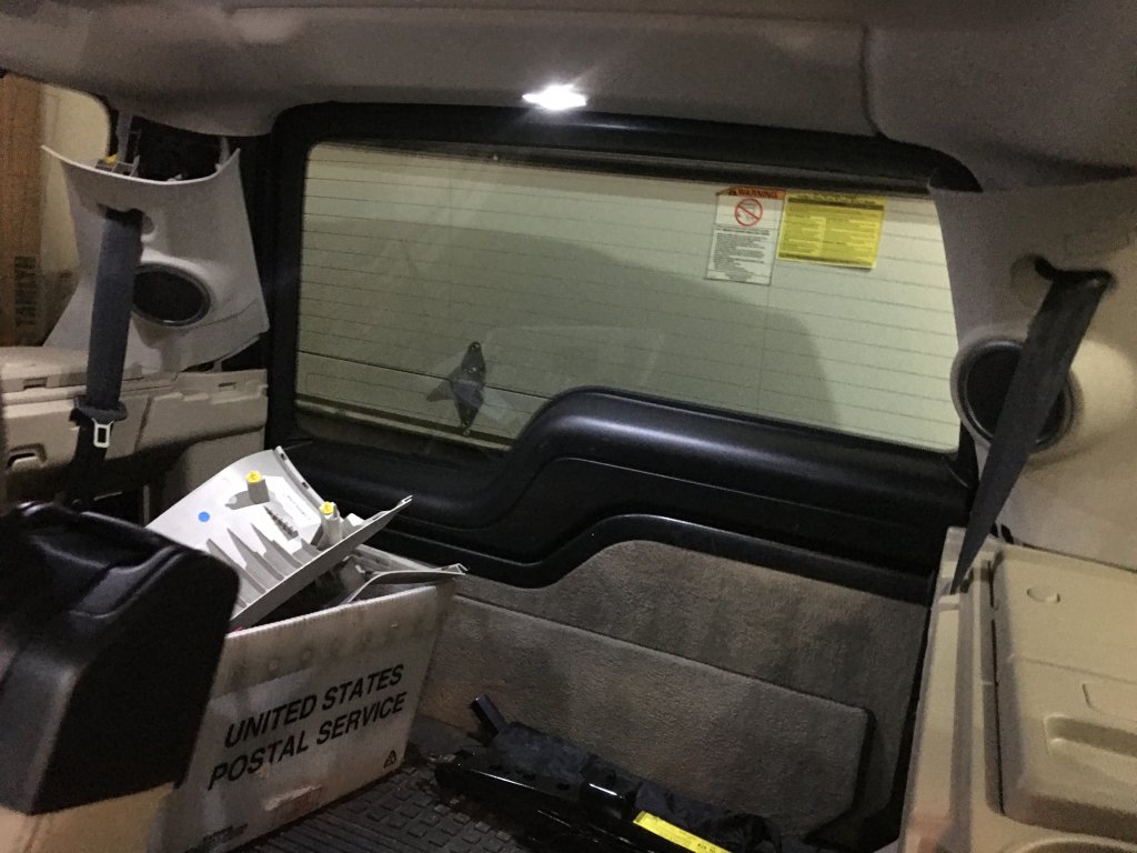

Thanks avslash. T50 worked great. Got my belts through the new speaker pillars.

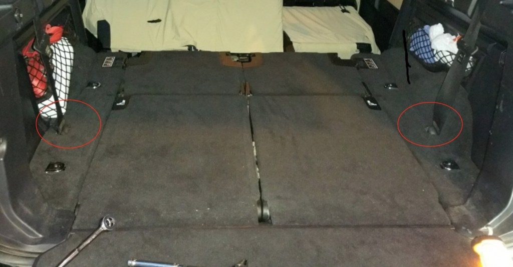

Does anyone have a guide on how to remove the bottom bolts on the seatbelts?
Tell me more about the cargo nets on either side of the loadspace, especially the one on the passenger side. I always wondered about the purpose of that indent there. Are the nets a custom bolt-on job? Never noticed them in the accessories catalog but may have missed them.
Here is one of the holders that I removed to get access to the seatbelt bolt. The carpet area lifts out enough to get the rachet in there.
