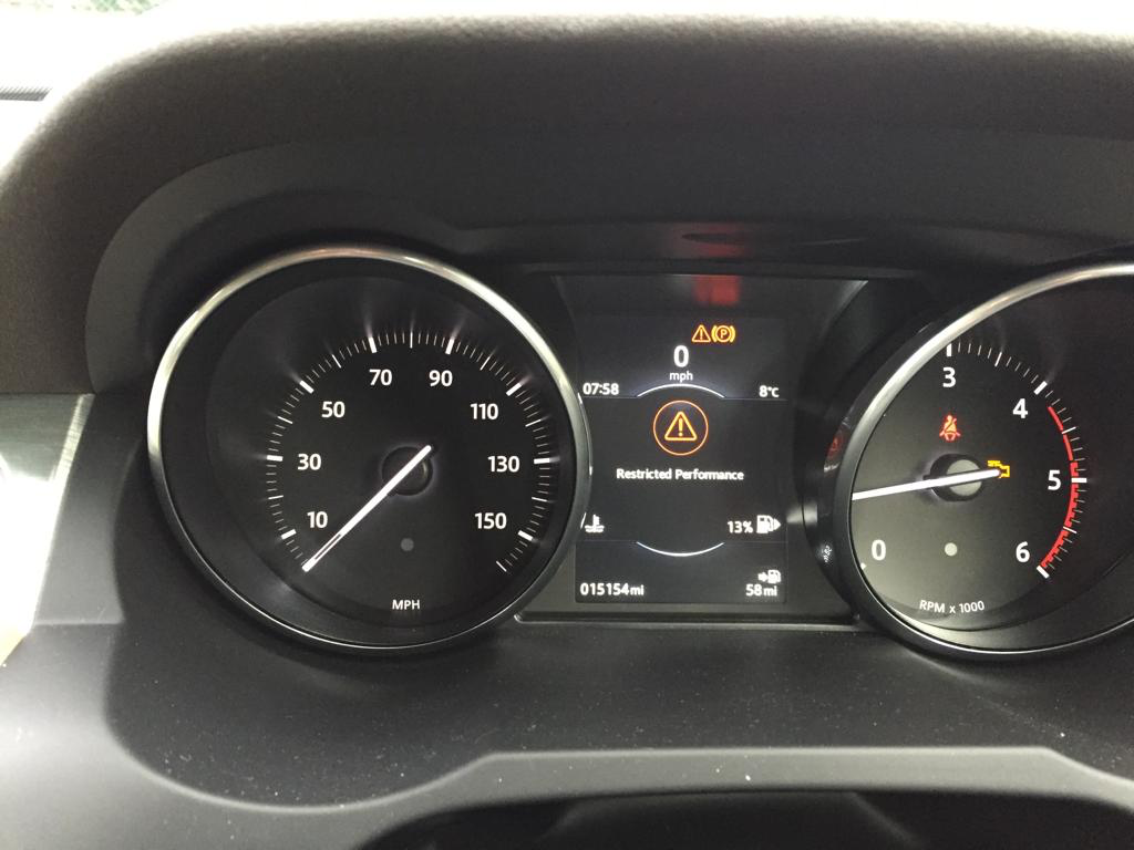

View attachment 8500Can anyone advise, what does this indicate?
Hello there,
I had same issue with my Evoque a few years ago, and the problem persisted for a year, as the dealer was not aware of the issue, they took a long time to find and solve the problem.
The problem was the sensor for the intercooler of the turbo location, which was detecting humidity and "restricted performance" message would appear.
Background:
My 2012 evoque had this issue for about 12 months, under specific weather encounters.
If it rained a lot, on a highway speed, or if I encoutered heavy fog also in highway speed, I would get that message, and a few times, the car just shut dow 2 cylinders and stopped.
In that case, I learned that if turned off the engine, and restarted, you were good to go again.
The dealer never found any fault by plugging the computer into the car...several times they told me I had BAD GAS...which was never the case...
