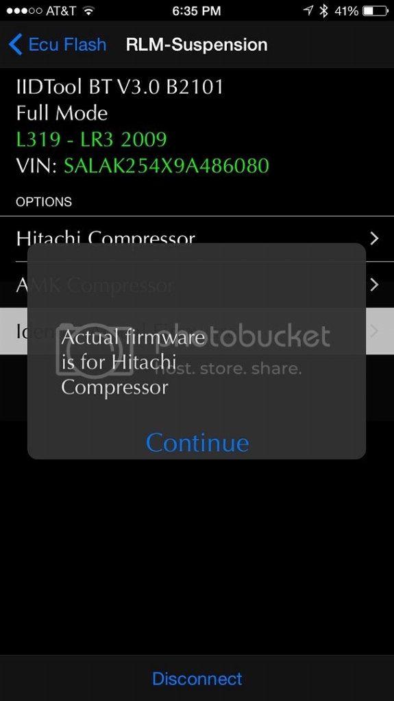

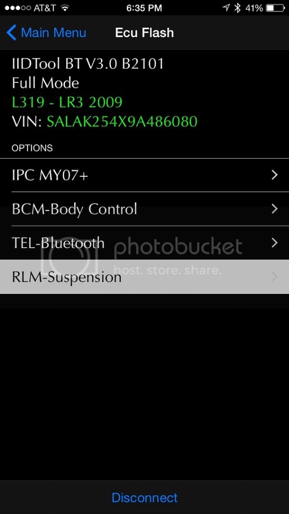

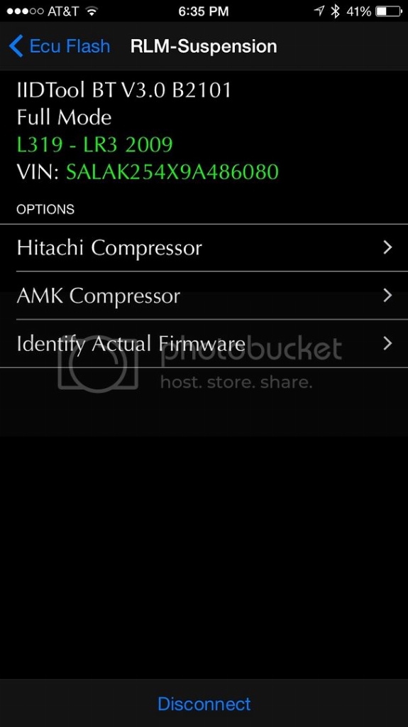

So, do this
Main Menu > ECU Flash > RLM-Suspension > Identify Actual Firmware
Awesome; thanks! I don't have the BT version but I imagine it's a similar process and menu structure.
