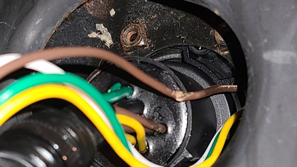

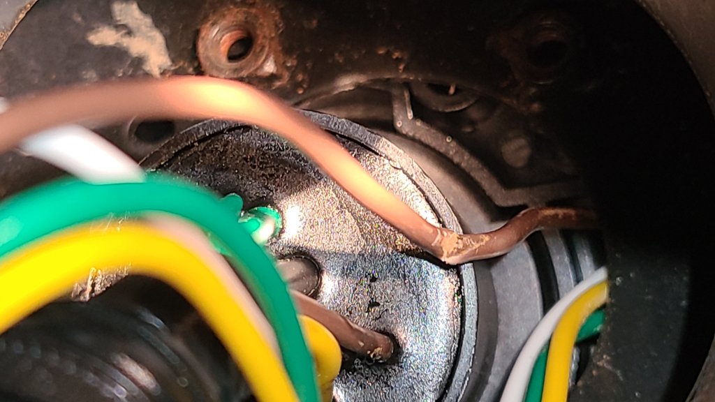

Bahhhhhhhh!!!! Sad #adulting night. While installing the BA kit, the Brown wire for the 4 pin connector got crimped when busting my hand and tail to get the connector seated through the bumper.
Pulled it and was going to to wrap in electrical tape and go (damage appears to have cut the covering but not the copper wiring) but the entire time I'm wrapping it my brain is telling me... "not a place to screw around" "brown controls brakes" "just get a new one" "do it right".
Bah! Just ordered a new one and emailed british Atlantic to see if they would like the other pieces back. Didn't make sense to put on the ox hitch since I'll just need to take it off again so my night of fun was well... not as satisfying as I had hoped!
But, going to lean into the positives... I have the time to wait for the new part. I learned more about my rig. I didn't hurt myself and I stayed busy for 2 hours tonight, lol. And now, after seeing how easy it is to remove the tail light assembly, am going to check out upgrading to the 2014 lights!
On attempt 2 I am going to consider installing with the 4 pin on the right vs left to take advantage of the additional notch out in the bumper.
