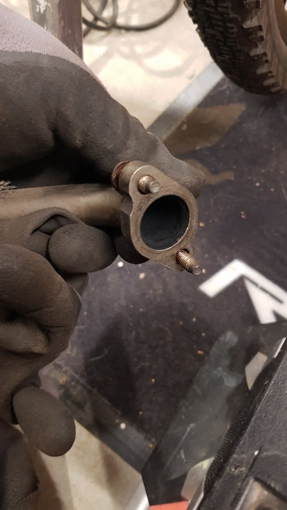

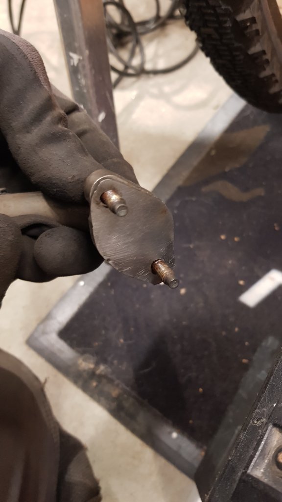

I FIXED IT!!!! what i did, i have disconecred EGR pipe that runs between the intake plenum and EGR valve, and I have completely colsed the end of that EGR pipe. It worked perfectly!!!
